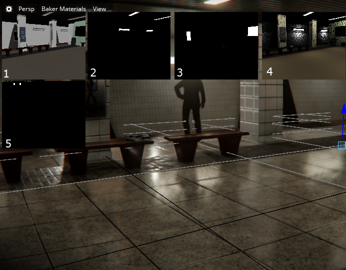

Baker Materials mode can be enabled by clicking the Full Render mode HUD in the Level Viewport, selecting Debug in the menu that appears, and then selecting Baker Materials. See Level Viewport.
The light baker transfers materials by saving them as low resolution textures. In Baker Materials visualization mode, you can see the scene as the light baker sees it.
To activate this mode, you must initiate a baking session. For more information, see Bake lightmaps.
Important: To view Baker Materials mode, you must select the viewport before initiating a baking session.
When your baking session is active, Baker Materials mode displays five smaller viewports, showing the following:
