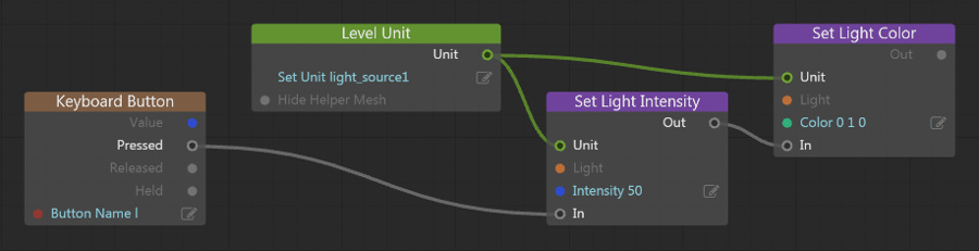

Flow offers a set of built-in nodes for getting and setting the properties of a light source. You can retrieve the light from the unit instance that contains the light you want to change, using the name set for the unit in the editor. This may be the "light helper" unit if you created the light in the editor, or your custom unit if you imported the light into the editor through an .fbx file.
See the nodes in the Light category in the Flow API reference; for example, Light > Get Light Color / Light > Set Light Color.
For example:
