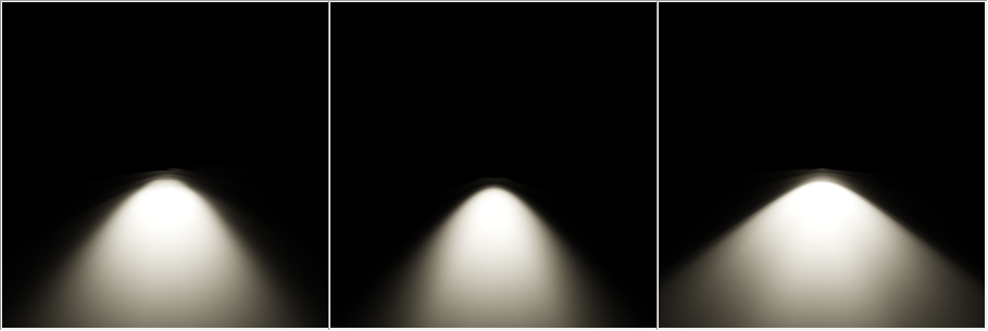

The following renders show IES profiles for lights from the Lithonia LDN4 Square Series, the LDN6 Round Series, and the LF6N Open series.
