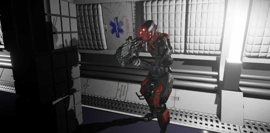

However, direct lighting on its own produces very sharp, very dark shadows. Anywhere that the rays from the placed lights do not reach ends up being rendered practically black. This gives a high-contrast, very dramatic effect. Level designers can balance this by placing more light sources in the level to fill in the dark areas, but a better approach is typically to add some indirect lighting to the scene. This indirect illumination fills in those shadowed areas so that their surfaces are still visible even when no direct light is hitting them.

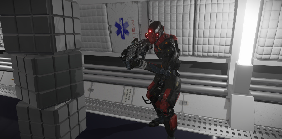

In the real world, light doesn't stop at one bounce. It reflects around from object to object until its energy is exhausted, getting around and behind objects. This creates indirect light that partially illuminates the shadowed areas, reducing the overall contrast.
The level of complexity involved in accurately simulating the spill of indirect light into shadowed areas is generally too much for the engine to simulate accurately in real time. However, there are a couple of techniques you can use to simulate indirect light without expensive runtime calculations.
You can set up your level's shading environment to add some global lighting to your scene: diffuse and specular light contributions that the real-time renderer applies equally to all surfaces in your level.
You typically set up this ambient light with textures baked by a reflection probe in order to make it seem like the ambient light is coming from the surrounding environment and/or the sky.
See Global environment lighting.

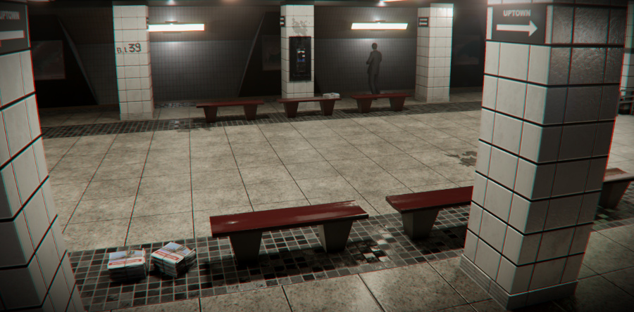

If you need to achieve more accurate and realistic indirect lighting without increasing the burden on the hardware running the engine, you can also try to bake your scene's lighting. This creates a set of texture files on disk, called "lightmaps", that contain the illumination that reaches each surface in your level.
Calculating these lightmaps takes extra time, and loading the lightmaps into the engine takes extra memory, but the runtime CPU performance and the realism are usually better than fully dynamic lighting.

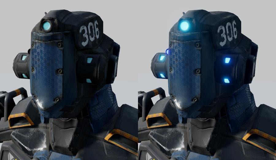

You can use the emissive property of your materials to make parts of your models appear to glow, like a car's taillights, LEDs on a machine, or a neon sign. You set up these emissive contributions in the materials that you use to shade the objects.
Emissive materials do not actually emit direct light onto other objects in your scene. The real-time renderer does not include any direct contributions from them. But, combined with a little bloom applied by the shading environment in post-processing, this makes an effective, low-cost way to simulate small light sources.
If you need an emissive object to shed direct light on the surrounding scene, you can pair it with a dynamic light source such as a spotlight, or bake it -- contributions from emissive materials do get included when baking indirect light.
