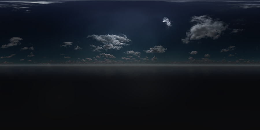

Your texture will be mapped onto the inside of the skydome sphere. It therefore needs to be a projection of spherical coordinates into a rectangular texture.
3ds Max Interactive expects your image to use equirectangular projection:
The X axis of the image wraps horizontally around the sphere (the longitude), and the Y axis of the image is up and down on the sphere (the latitude).
The center of the Y axis is the equator: around this line the image will appear on the skydome without any distortion.
The top and the bottom of the image represent the top and bottom poles of the skydome. As you approach these points, each horizontal line of pixels in your texture is compressed to fit a smaller circumference around the surface of the sphere.
For example, in the default skydome image, notice how the clouds appear stretched out at the top of the image. When projected onto the skydome, they converge and appear seamless.
Your texture should be twice as wide as as it is high, like the default texture above. If not, it will be stretched or squashed as necessary to fit onto the sphere.
You will likely need to keep your texture quite large in order to make sure that its features will look crisp enough when projected onto the skydome.
For example, the default skydome texture is 4096x2048. This does produce quite a large file, but avoids the artifacts or pixelation that you are likely to see in the sky with lower-resolution images.

If you enable fog for your level, you may want to blend in the fog color toward the horizon in order to enhance the effect of distance in your scene.
Fog applies to the objects in your scene, but not to the background skydome. If the skydome texture near the horizon contains elements that are clearly visible, but the objects in front of it are obscured by a different color of fog, the result can look unnatural.
For example, the default skydome texture shown above fades to a light grey at the horizon, which matches the fog color in the default shading environment.
