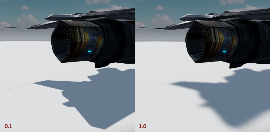

Log/Linear Blend
Controls the edge bleed of your shadows. Lower values produce sharper shadows, higher values produce softer shadows.

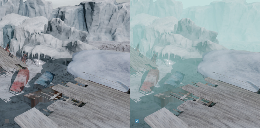

Fog covers up distant objects with a colored overlay that becomes progressively more opaque as the distance from the camera increases. Fog can enhance the feeling of depth and distance in a level by making far-off objects appear to become occluded by the atmosphere.
Enabled
Turns fog on and off.
Depth Range
The Min value sets the distance from the camera at which the fog begins to affect the objects in the level.
The Max value sets the distance from the camera at which the fog reaches its maximum opacity.
Fog Color
Controls the color and the maximum intensity level of the fog overlay.

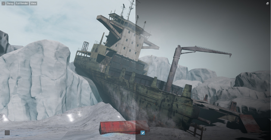

Exposure
Adjusts the overall brightness of the scene. Lower values produce a darker image, higher values produce a lighter image.

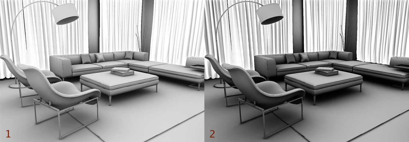

Screen Space Ambient Occlusion
Screen space ambient occlusion applies an extra layer of shadow where objects are close together. This simulates the way the presence of other adjacent objects tends to reduce the amount of ambient diffuse light that reaches a surface. This tends to deepen the shadows inside small gaps, at angles, and at corners.
Screen space ambient occlusion is a post-processing effect that applies to all rendered objects in the scene, using the depth of the objects in the scene to determine which ones are close enough to occlude each other. Note that you can also set up ambient occlusion at the level of individual models or materials, by baking an ambient occlusion map from your content creation tool and assigning its texture to the AO Map slot of your material. See the topics under Shading for more on setting up physically based materials.
The editor viewport also offers a visualization mode that can be helpful to use when tuning the screen space ambient occlusion settings. Activate it from the viewport overlay by selecting Full Render > Lighting > SSAO.

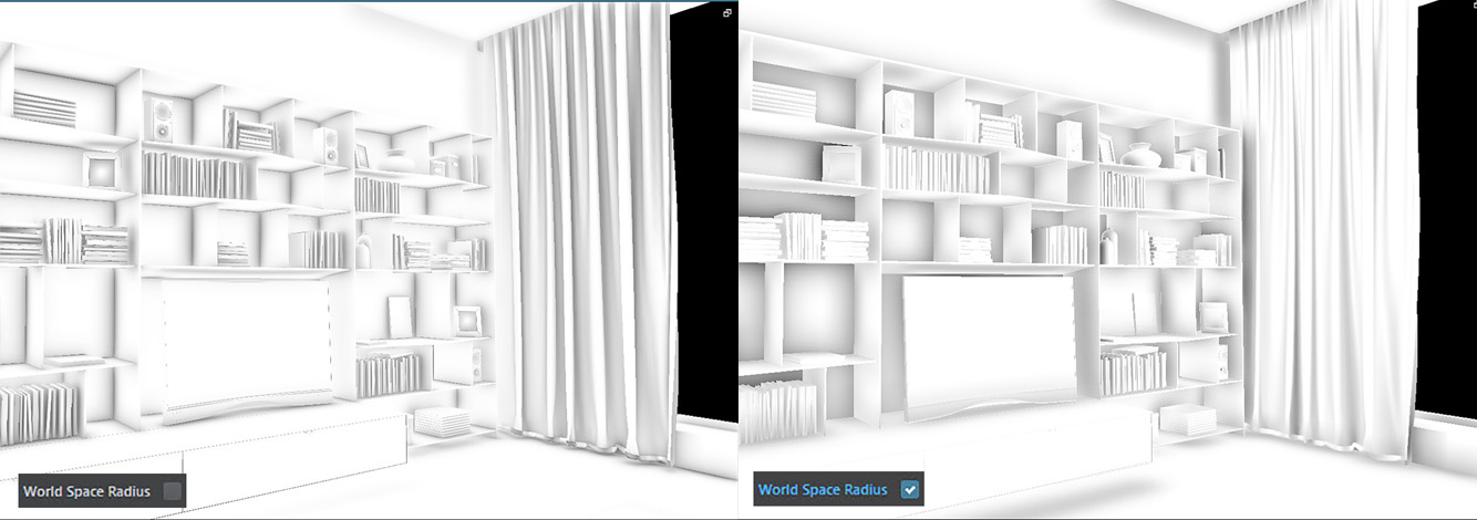

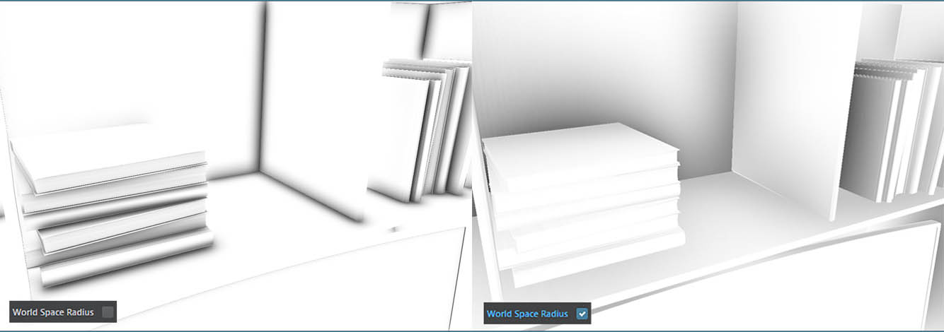

World Space Radius
When enabled, calculates the radius of the ambient occlusion hemisphere in world units. When disabled, screen units are used.
In the following example, the camera is zoomed in on objects. Screen space radius reveals different features on the objects, while World Space Radius remains constant.

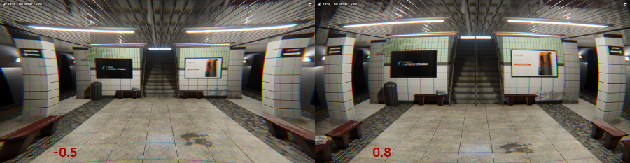

Angle Bias
Angle Bias prevents self occlusion in your scene. In the following example, the self intersection issues are fixed by increasing Angle Bias to 0.2.

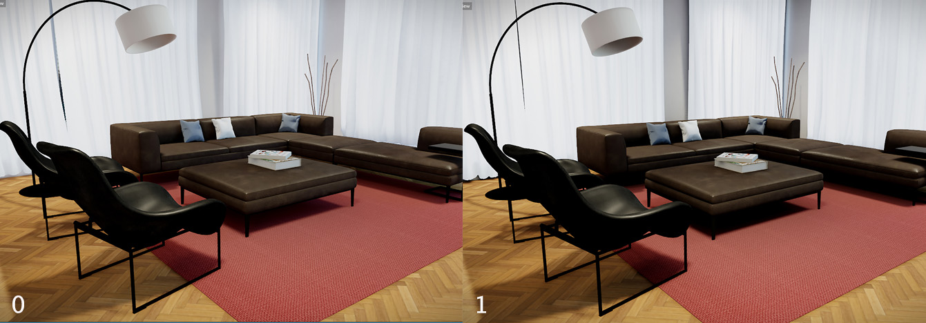

Reflection Occlusion Intensity
Controls the amount of baked data that is used where occlusion is high. Modify this value if the reflection is removing too much of the contact shadows in your scene.
Reflection Occlusion Falloff
Scales the contribution from the baked AO, offering more artistic control. Modify this value if the reflection is removing too much of the contact shadows in your scene. In the following example, Reflection Occlusion Falloff was increased, and AO vizualization mode is used to illustrate the results.
Baked Diffuse Intensity
Controls the intensity of ambient data. Modify this value if you want more contribution to the diffuse lighting from your light baked AO.
Blur
Controls the amount of smoothing applied to the shadow. Lower values leave a sharper edge on the shadow, but can have a speckled or dithered appearance. Larger values produce smoother, more even results.

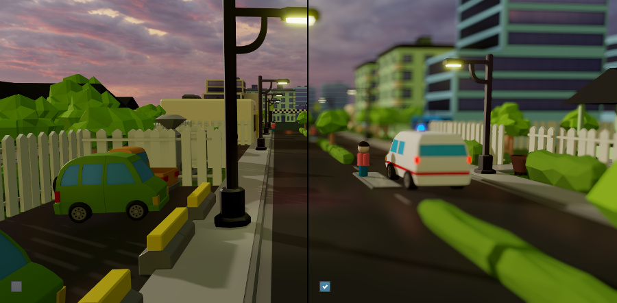

Screen space reflections are calculated for reflective materials in real time within each frame. This is a post-processing effect that bases the reflections on the depth of the objects rendered in the scene. For details on this technique and how it fits in with other techniques for making reflective surfaces, see Reflections.
Enabled
Turns screen space reflections on and off.
Screen Edge Threshold
Controls the width of the screen area adjacent to the edge of the viewport in which the reflections are either faded out or bent.
Number of frames
Total number of frames to accumulate over time.
Samples per frame
Total number of samples per pixel for one frame, increasing this value will significantly impact performance.

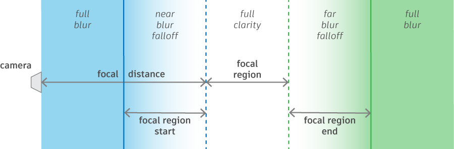

Focal Distance
The distance from the camera at which objects start to be in perfect focus.
Focal Region
The distance that the area of full clarity extends past the focal distance.
Focal Region Start
The distance from the start of the focal region (i.e. the focus distance) to the point where the near blur reaches its full strength.
Focal Region End
The distance from the end of the focal region to the point where the far blur reaches its full strength.
Focal Near Scale
Adjusts the falloff for the near blur. Smaller values produce a smoother transition, making the amount of blurring increase more gradually over the distance set by the focal region start control. Larger values make the transition from clarity to blur happen more quickly and closer to the central focal region.
Focal Far Scale
Adjusts the falloff for the far blur. Smaller values produce a smoother transition, making the amount of blurring increase more gradually over the distance set by the focal region end control. Larger values make the transition from clarity to blur happen more quickly and closer to the central focal region.

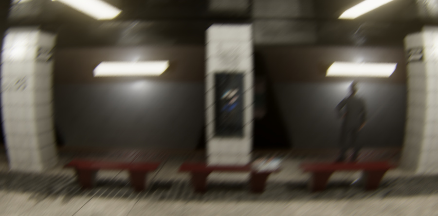

When the camera is moving, this effect causes the image to blur in the direction of the camera's movement. The blurring becomes more pronounced as the speed of the camera movement increases.
For example, in the following image, the camera is panning up and to the right, causing the scene to blur along the diagonal axis.
A small amount of motion blur can cause camera movement to appear smoother and more like a film camera. However, too much motion blur can be disorienting or jarring when the camera begins to move and when it stops moving, as the image snaps back to full clarity.

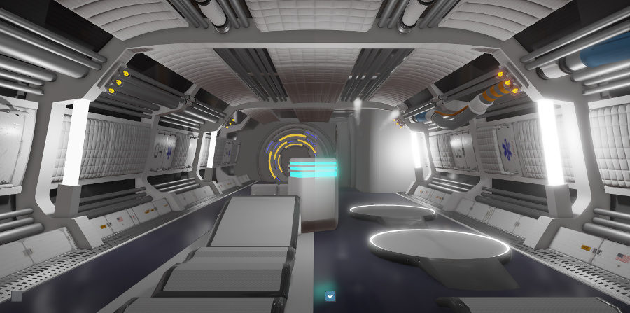

Bloom is a photographic effect that adds a glow around the edges of bright areas of the image. It makes the bright areas appear to bleed in to the surrounding parts of the image, increasing the apparent brightness of the lighter area.
The editor viewport also offers a visualization mode that can be helpful to use when tuning bloom settings. Activate it from the viewport overlay by selecting Full Render > Post > Bloom.
Enabled
Turns bloom on and off.
Threshold
Controls how bright things in your scene need to be to trigger the bloom effect. Lower values trigger bloom more readily.
Offset
Controls how large each bloom effect will be. Lower values produce wider, bigger glow.
Falloff
Controls how long and how soft the falloff of the glow will be. Smaller values make the glow begin fading out closer to the maximum distance; this produces a brighter center that fades out more quickly. larger values make the glow begin fading out closer to the source; this produces a softer glow that fades out more gently.

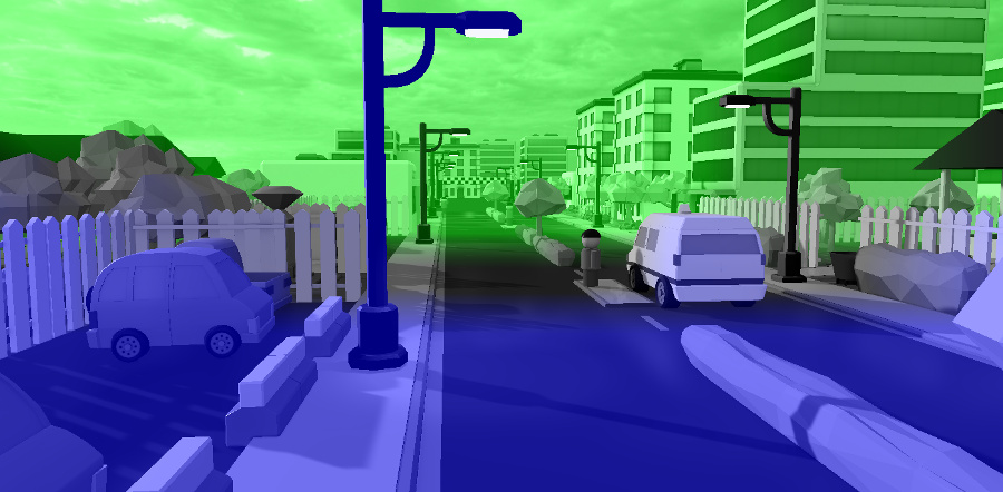

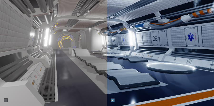

Color grading changes the color space of the rendered images produced by the renderer. The effect is to adjust things like the colors, hue, saturation, and brightness of the viewport, based on a volume map texture that you provide.
For example, the following image boosts the contrast and shifts the colors toward blue.
See also How to apply color grading to a level.
