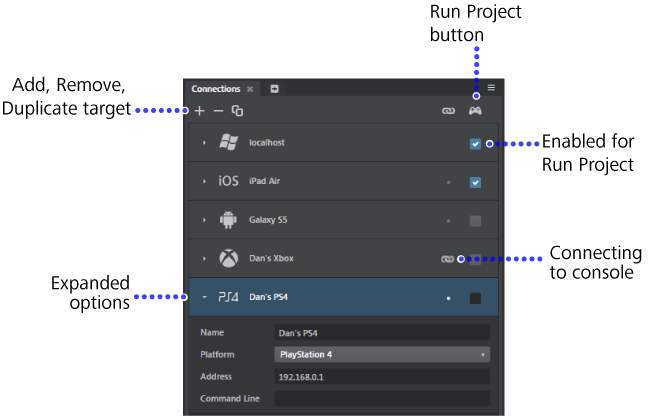

You can use the Connections panel to configure remote devices and web browsers as targets for the interactive editor. Once set up as a target, you can run your project on the device or in the browser. You can also mirror the editor viewport to a connected device. (Mirroring the viewport to a browser is not currently supported.)
To...
Add a target platform Click in the toolbar, expand the new target and enter a name, platform type and IP address.
Remove a target platform Select the platform and click in the toolbar.
Duplicate a target platform Select the platform and click in the toolbar.
Launch a data compilation for a target platform Right-click the target and select Compile Data or Compile and Bundle Data.

Each connection you configure requires the following settings:
Name
A descriptive name for the target device or browser. You'll use this name elsewhere in the editor and the External Console to refer to the device or browser that you configure here.
Platform
Specifies the type of device or browser represented by this connection.
Address
The IP address or network resource name of the target device. You must set this value to the correct address for your device, regardless of which platform you target. (Not required for web targets.)
Command Line
Any text that you enter in this control will be passed to the engine on the command line when it is launched on that target. You can use this option to control certain aspects of the engine's operation.
For example, you could use the --ini setting to boot the engine from a different settings.ini file in order to test different configurations, or use the --hold option to make the engine pause on startup until a debugger attaches to the process.

  1. Select the check box for your target below the Run Project button in the Connections panel. This marks the selected device as a run target.
  2. Click the Run Project button at the top of the Connections panel.

  1. Press to add multiple new targets.
  2. Set each target to use the Windows platform, with IP address 127.0.0.1. Make sure the Run Project box is checked for each target.
  3. Each target needs different command-line parameters. Two targets with the same name and same command line will only result in the engine launching once.
