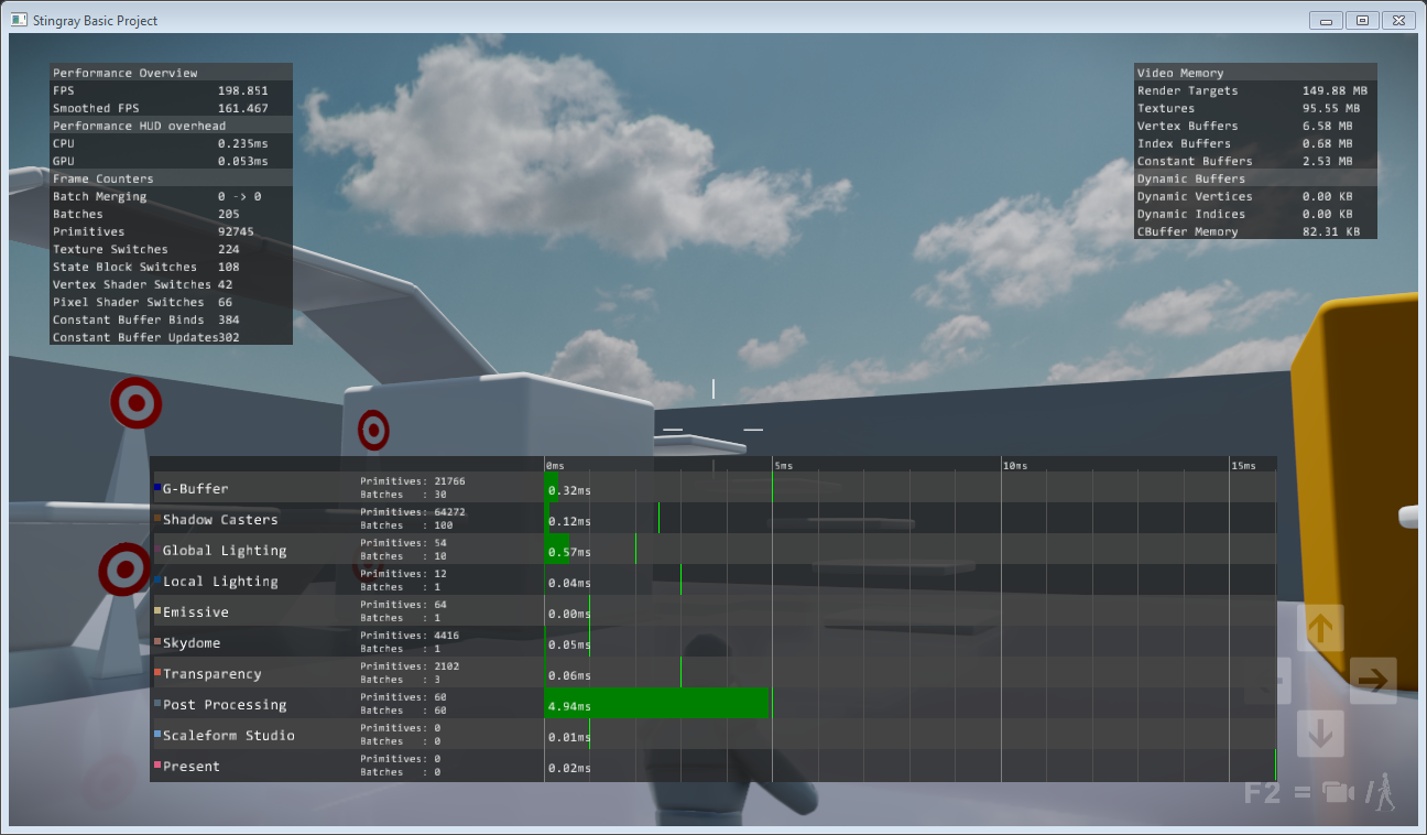

The engine has some built-in systems that display diagnostic messages and render debug information in the same 3D viewport that renders your project content. You can use these systems to print performance statistics, visualize performance as a graph, or to debug subsystems like physics and particles.
You toggle the display of these diagnostic systems by sending console commands to the engine from the Status bar of the editor, or from the External Console application (Window > External Console).
For details, see Send commands from the Status bar.
For a list of all console commands, see Console commands. In particular, look for the useful perfhud, graph, and physics commands.
While you're working in the interactive editor, you can turn the HUDs on in your editor viewport. This shows the performance of the instance of the interactive engine that is run internally by the editor, powering the viewport display.
Click View > Performance Hud in the viewport's visualization settings, and select the HUD you're interested in.
