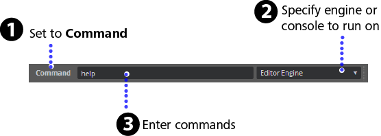

You can use the Status bar at the bottom of the interactive editor to send simple commands to an instance of the engine that you started from the editor. This can be a local instance of the engine on your PC, the Test Engine, or the engine running on a connected console.
For example, you can execute a command that draws a performance HUD in the engine viewport by entering perfhud artist or perfhud network. You can use other commands to enable and disable the built-in profiling system, toggle the display of performance statistics in the engine viewport, or pause and resume the engine itself.
To execute commands from the Status bar:
For a detailed reference of all available commands and parameters, see Console commands.
You can also retrieve brief descriptions of the commands by typing the help command in the Status bar command line. For brief descriptions of the parameters accepted by a single command, type help <command>, where <command> is the name of the command you want to execute. Open the Log Console window to see the output of the help command.
