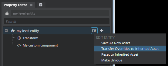

To apply all modifications from an entity back up to its inherited asset:
Select the entity in either the Asset Browser or the Explorer panel.
In the tree view of the Property Editor, click the
icon and choose Transfer Overrides to Inherited Asset from the contextual menu.
Any overrides in the entity are applied to its inherited asset, and the inherited asset is marked as modified.
Make sure to save the change to the inherited asset. Press Ctrl+Shift+S. Or, select it in the Asset Browser and click the
icon in the Property Editor.

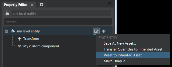

To discard all modifications made to an entity:
icon and choose Reset to Inherited Asset from the contextual menu.
Make sure to save the change to the entity.
If the entity is an .entity asset, press Ctrl+Shift+S. Or, select it in the Asset Browser and click the
If the entity is in a level, press Ctrl+S to save the level.

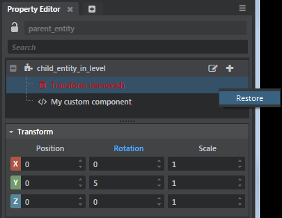

To restore a deleted inherited component:
In the tree view of the Property Editor, inherited components that have been deleted in this entity are listed in red.
Right-click the name of the component you want to restore. From the contextual menu, choose Restore.
