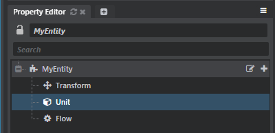

Each individual component within an entity has to have an ID that is unique within the entity that owns it. This name is shown in the Property Editor when you have the entity selected, like Transform, Unit and Flow here:
It's also how you get access to a particular component in Flow and Lua so that you can get or set its property values.
