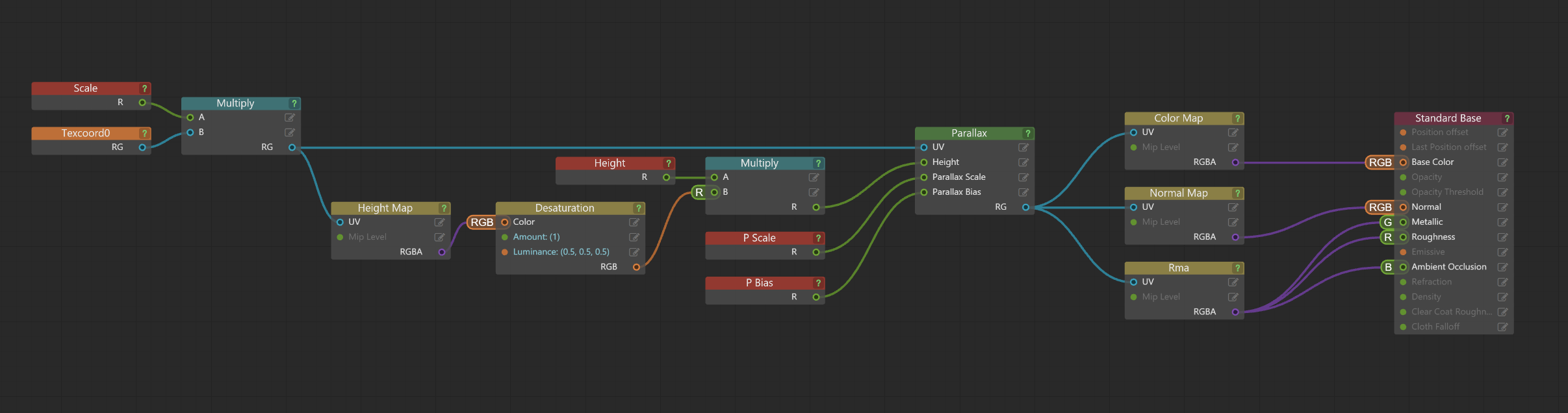

This node gives a surface the illusion of depth by shifting the UV coordinates of the
pixels being shaded according to the height of the pixels from the surface and the
camera's point of view.
| Inputs | |||||
vector2 | UV |
The input UV that will be adjusted by the height value. | ||
scalar | Height |
The height of the pixel being shaded, usually drawn from a height map or bump map texture. | ||
scalar | Parallax Scale |
The amount of apparent deviation the heightmap causes in the surface. Default value: 0.04 | ||
scalar | Parallax Bias |
A constant amount subtracted from the height in order to cause "lower" pixels to appear sunken below the surface plane. You will typically want this value to be about half of the parallax scale value, so that the median of the low and high points will lie approximately on the level of the original mesh surface. Default value: 0.02 | ||
| Outputs | |||||
Out | auto |
The output value or values produced by this node. | |||
| Pre-requisites | Output nodes | This node can only be used in a shader graph that contains the following output node: | |||
This means that "lower" pixels can be occluded by "higher" pixels.
The technique used by this node is known as "parallax mapping" or "bump mapping". It is similar to normal mapping, except that instead of using a map that contains the normal vectors of a surface, it typically uses a greyscale map (a scalar input value) that determines the height of the surface. Lighter color values or higher scalar values are "higher" in relief, and darker color values or lower scalar values are "lower".
For example:
Visit the AREA to download this sample parallax shader and watch our tutorial on Parallax Mapping in Stingray.
Node definition in file: core/shader_nodes/parallax.shader_node
