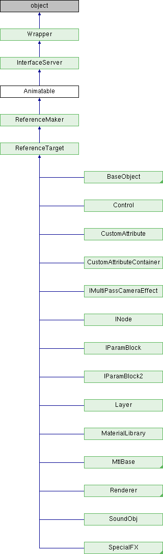

Inheritance diagram for Animatable:Public Member Functions | |

The base class for most scene entity and plugin types.
