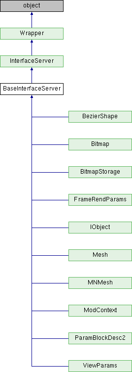

+ Inheritance diagram for BaseInterfaceServer:

Detailed Description
Enables enumeration of interfaces supported by an object.
