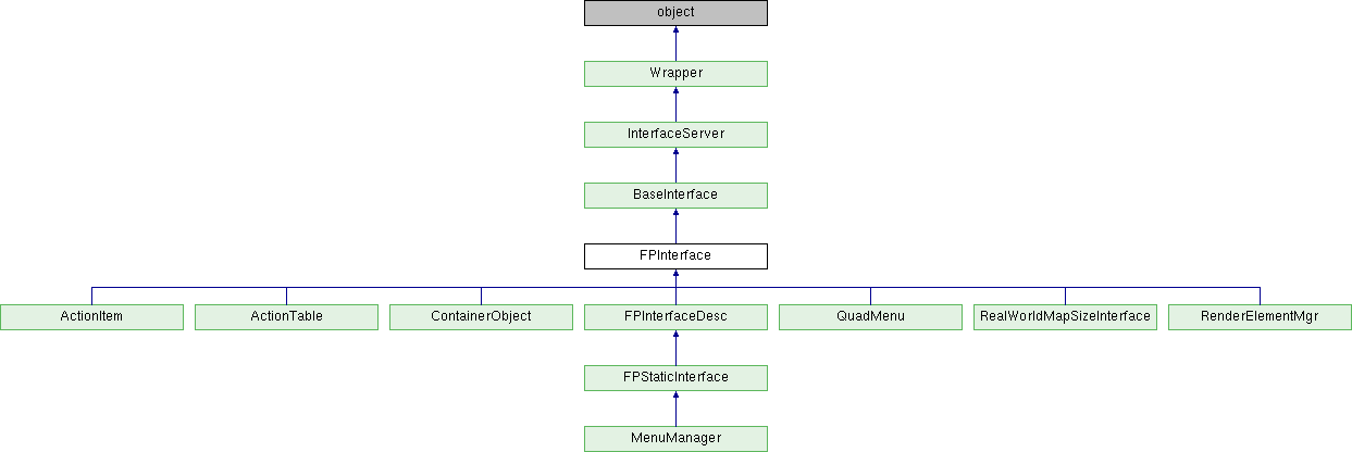

Inheritance diagram for FPInterface:Public Member Functions | |
