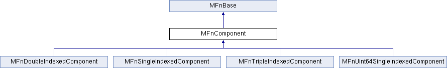

Base class for component function sets.
This is the base class for all function sets which deal with component objects.
Components are MObjects which hold index information for shapes. The component object does not contain any information about the shape, it just contains index values and type information.
Components can be marked as complete meaning that the component represents a complete set of indices from 0 to numElements-1;
Components come is 3 varieties based upon the dimensions of the index. The types are single, double, and triple indexed. Examples of these types are mesh vertices (single indexed), nurbs surface CVs (double indexed), and lattice points (triple indexed).
To create, edit, or query a specific type of component, use the derived classes MFnSingleIndexedComponent, MFnDoubleIndexedComponent, and MFnTripleIndexedComponent.

Reimplemented in MFnDoubleIndexedComponent, MFnSingleIndexedComponent, MFnTripleIndexedComponent, and MFnUint64SingleIndexedComponent.
