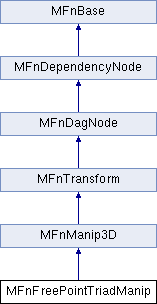

+ Inheritance diagram for MFnFreePointTriadManip:
