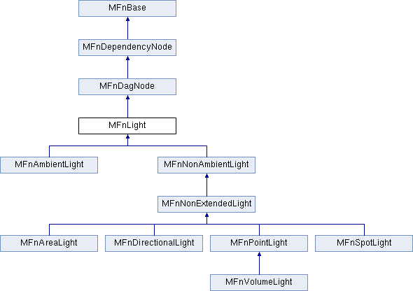

Inheritance diagram for MFnLight:Public Member Functions | |

Manage dependency graph nodes representing lights.
MFnLight allows the creation and manipulation of dependency graph nodes representing lights. This is the top level of a hierarchy of light node function sets. It permits manipulation of the attributes common to all types of lights.
virtual |
Destructor.
The class destructor.
virtual |
Function set type.
Return the class type : MFn::kLight.
Reimplemented from MFnDagNode.
Reimplemented in MFnSpotLight, MFnNonAmbientLight, MFnNonExtendedLight, MFnAmbientLight, MFnAreaLight, MFnDirectionalLight, MFnPointLight, and MFnVolumeLight.
static |
Returns the name of this class.
Return the class name : "MFnLight".
