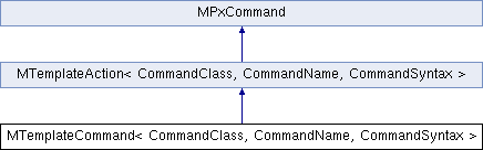

Inheritance diagram for MTemplateCommand< CommandClass, CommandName, CommandSyntax >:Public Member Functions | |
