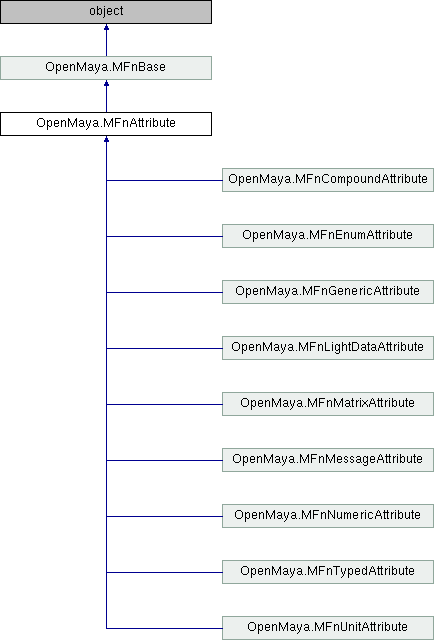

 Inheritance diagram for OpenMaya.MFnAttribute:
 Inheritance diagram for OpenMaya.MFnAttribute:| Public Member Functions | |

Base class for attribute functionsets. Method resolution order: - MFnAttribute - MFnBase - __builtin__.object
MFnBase<h2>Constructors
