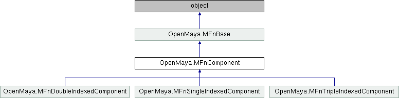

 Inheritance diagram for OpenMaya.MFnComponent:
 Inheritance diagram for OpenMaya.MFnComponent:| Public Member Functions | |

This is the base class for all function sets which deal with component objects. __init__() Initializes a new, empty MFnComponent object __init__(MObject component) Initializes a new MFnComponent function set, attached to the specified component. Method resolution order: - MFnComponent - MFnBase - __builtin__.object
