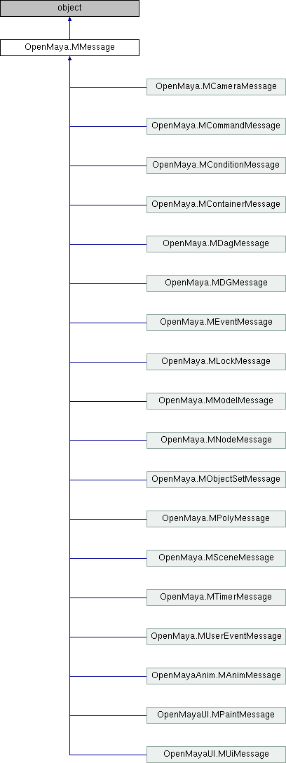

 Inheritance diagram for OpenMaya.MMessage:
 Inheritance diagram for OpenMaya.MMessage:| Static Public Member Functions | |
