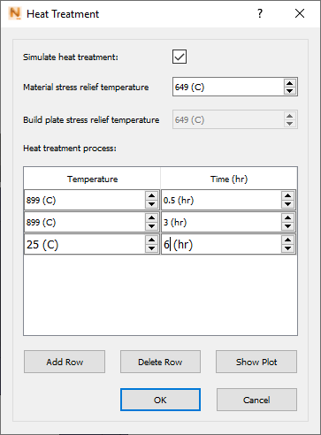

  3. Click Home tab > Heat Treatment.
  4. In the dialog, select Simulate heat treatment, and set the Material stress relief temperature to 649 (C).
  5. In the Heat Treatment process table, set the values shown:
    The time value for a particular temperature phase indicates the elapsed time from the beginning of heat treatment to the end of that temperature phase. The system will check that the times are a series of increasing values.
  6. Click OK to close the Heat Treatment dialog, then click Solve.

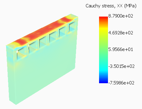

  8. Now view the Cauchy stress results. On the Display tab, check that the Component value is XX to focus on the longitudinal stress, and change the Range setting to Global.
    Maximum stress occurs in the first increment of heat treatment (shown below), then gradually relaxes.
