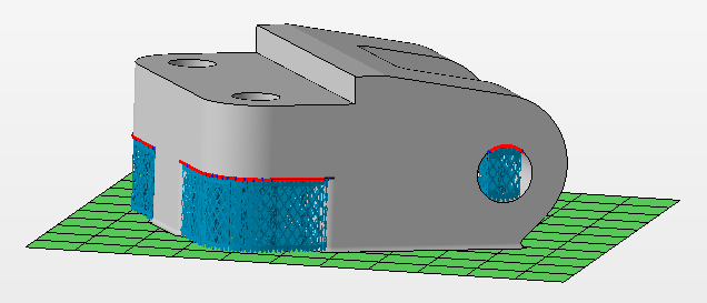

  7. Click Create Supports.
  8. At the bottom of the window, click Run Support Script, in the Choose support script dialog select SLM, and click Execute.
    The lattice-like supports are created.
  9. Click Apply support.

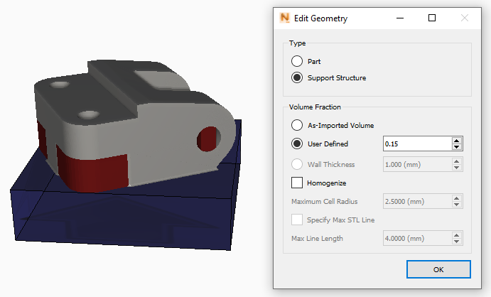

  13. In the Simulation Utility Browser, right-click the support structure, which has a name that includes _hulledsupport_, and select Edit Geometry.
    One benefit of using Netfabb to generate supports appears here, in that the Volume Fraction is automatically calculated during support creation. Volume fraction is the amount of the support volume that is occupied by physical structures rather than empty space. Leave the existing value unchanged.

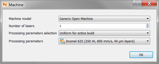

  15. In the Machine dialog, set Machine Model to Generic Open Machine and Processing Parameters to Inconel 625.

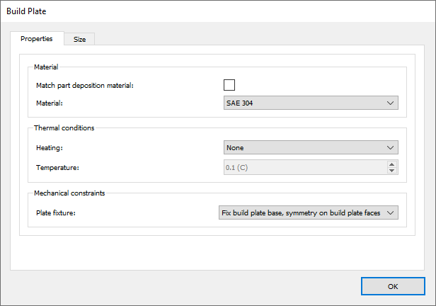

  16. In the Build Plate dialog, click the Properties tab; here deselect Match part deposition material and set Material to SAE 304.

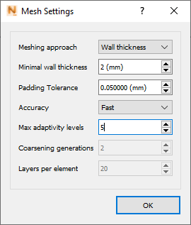

  17. Click OK, then click Mesh Settings. Set the Meshing approach to Wall thickness, and Minimal wall thickness to 2 mm.

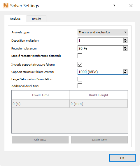

  18. Click OK, then click Solver Settings. On the Analysis tab, select Include support structure failure, and set the failure criteria to 1000 MPa.

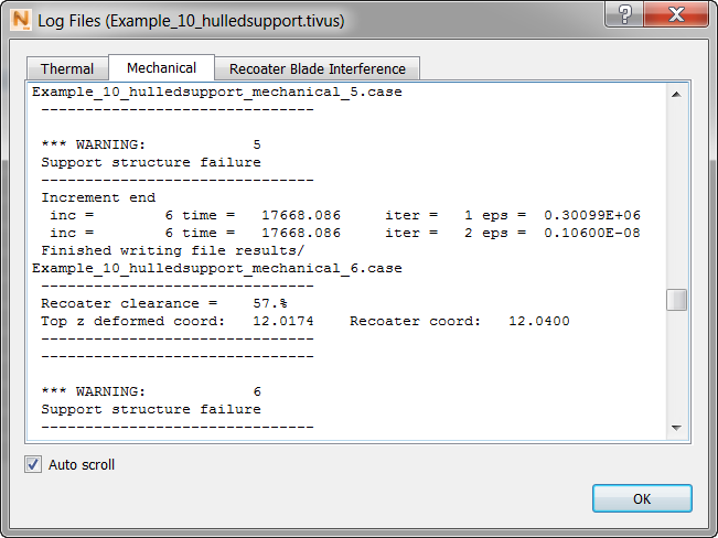

  20. Click Results tab > View Logs to read the solver output.
  21. In the Log Files window, click the Mechanical tab, and scroll down, looking for Warnings.
    You probably see several warnings of support structure failure. These indicate that the support structure failure criteria, specified in MPa units in the Solver Settings, was exceeded during simulation.

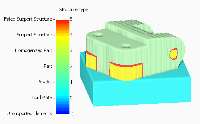

  22. In the Browser Results folder, use the light bulb icons to show the Structure Type results. In the Animation panel, move the increment slider to the right to view the last increment before build plate removal.
    The Structure type results are color coded into 7 different element types, and the failed support structures are clearly visible in red.

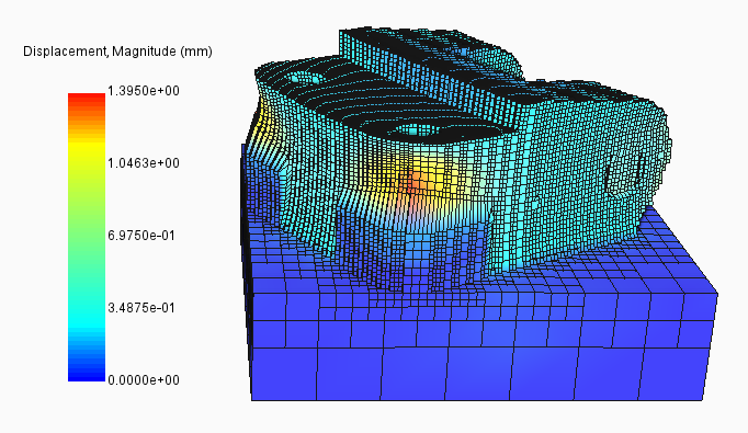

  24. Click the light bulb icon to show the Displacement results.
  25. In the Display panel, select Warp by Displacement, and change the Displacement Scale to 5.0 to exaggerate the displacement five times.
    For this example, you may want to turn the Element Edges back on in the Browser. The warped displacement results with visible element edges should look similar to the figure below:
    Note that the elements at the support-part interface look distended. Rotate the part and zoom into the distended region.
