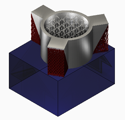

  3. Import the part file Lattice.stl, set the Volume Fraction to As Imported Volume and select Homogenize. These settings will create a volumetric 'shrink wrap' of the Lattice component using a Volume Fraction calculated from the volume of the imported STL file.
  4. Import Support1_Solid.stl, set Type to Support Structure, Volume Fraction to User Defined 0.22, and select Homogenize. This represents the case when you have pre-calculated the Volume Fraction or are investigating support structure density using the simulation.
  5. Import Support2_0Thickness_Loose.stl, set Type to Support Structure, select Homogenize, and set Volume Fraction to Wall Thickness of 0.22 mm. This case corresponds to the common occurrence when you do not know the volume or volume fraction of a zero-thickness lattice type support, so you choose this setting to calculate this based upon the support structure wall thickness.
  6. Import Support3_0Thickness _Fine.stl, set Type to Support Structure, select Homogenize, and set Volume Fraction to Wall Thickness of 0.15 mm. These settings are chosen to show that a variety of support designs may be applied to different support STLs.

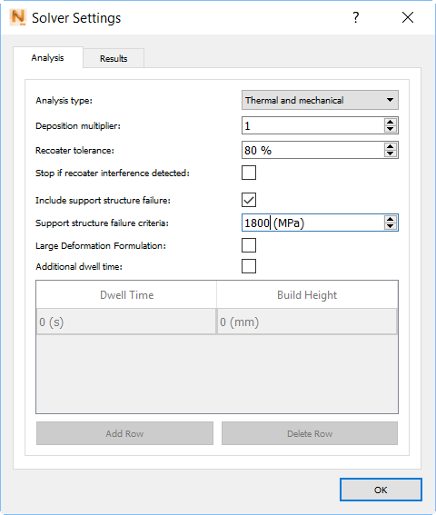

  7. On the Home tab, open Solver Settings.
  8. On the Analysis tab, select Include support structure failure, and set Support structure failure criteria to 1800 MPa.

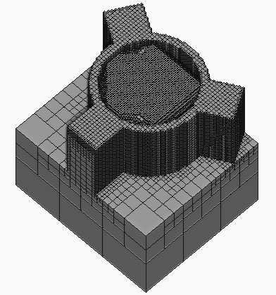

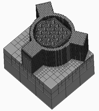

  9. Click Mesh Preview to generate a mesh for all parts and supports.
    Note the dimpled top of the lattice part mesh inside the hole of the spoked cylinder.

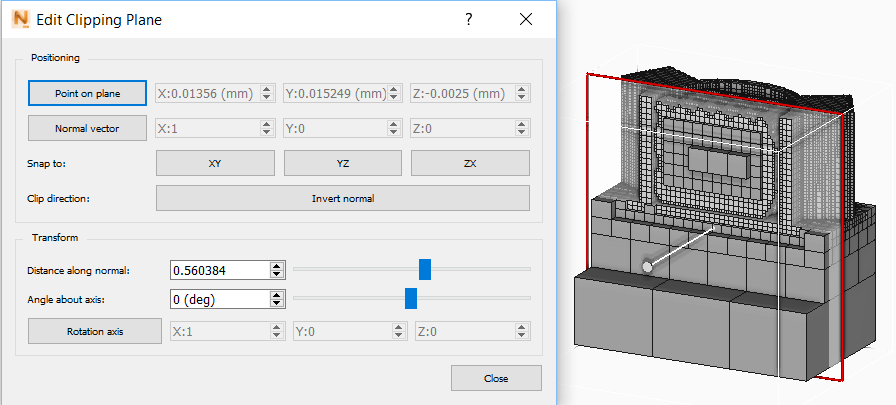

  10. To view the mesh in more detail, go to the View tab and click Clipping . In the Edit Clipping Plane dialog, select Snap to YZ to orient the plane, and use the Distance along normal slider to move the plane along the X axis. If you want to slide the plane along the Y axis, select Snap to ZX.
  11. To restore the full mesh, close the Edit Clipping Plane dialog, and click the Clipping icon again.

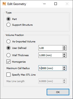

    The irregular mesh is created because the gaps in the lattice are too large to be spanned by the default Maximum Cell Radius. The Maximum Cell Radius sets the largest gap or feature that will be filled in during Homogenization. By default, this value is 2.50 mm, meaning that lattice holes up to 5.00 mm across will be homogenized. However the features of the Lattice component in this example obviously exceed 5.00 mm. We can improve the lattice mesh by increasing the maximum cell radius setting.

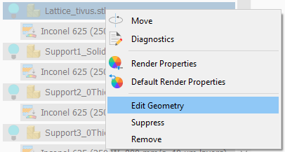

  12. In the Browser, right-click Lattice_tivus.stl > Edit Geometry.
  13. In the Edit Geometry dialog, select Homogenize, change Maximum Cell Radius to 5.00 mm, and click OK.
  14. On the Home tab, click Mesh Preview to regenerate the mesh. You should notice that the lattice mesh is much smoother.

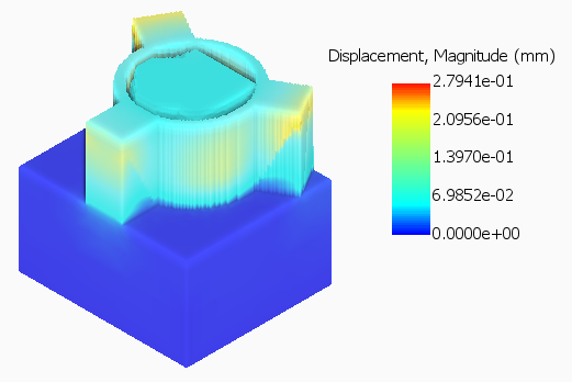

  15. Click Solve to run the simulation.

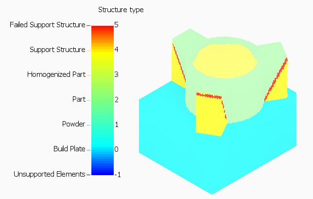

    The Displacement results show that the different densities of support structures affects the part scale distortion of these parts. You can use this data to optimize support design, which can be done much more rapidly than if all the supports were modeled directly with very fine meshes.
    The Structure Type results show severe support structure failure. This indicates that the supports are likely too weak and should be made more dense.
  16. Finally, if you examine the mechanical log file, you will see critical warnings indicating both support structure failure and recoater blade interference, which should be taken into account when approaching the redesign of this component and its supports.
