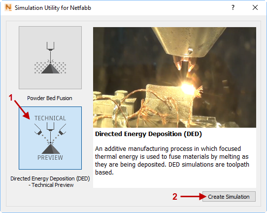

  1. In Simulation Utility, Click Simulation menu > New.
  2. In the dialog that opens, click Directed Energy Deposition, and then Create Simulation.

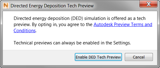

    If you have not opted in to the DED technical preview, you will be offered the opportunity to do so.
    More information is available at Simulation menu > Settings > Preview tab.

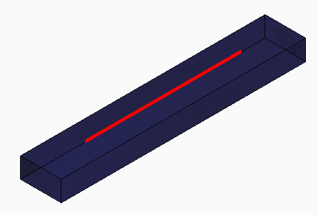

  3. In the Import model dialog, browse to your tutorial example files, open the file Example_18\path.lsr, and accept the default Converted model units settings.
    Let's examine the contents of this file in a text editor.
    Each laser vector has one line of data, and the order of entries is listed in the top two commented lines:
    • First entry on the left is the power: 450 W in this case.
    • Laser vector in X Y Z format in relation to the build plate: 0 0 -1 here means that the laser is pointing straight down.
    • Starting X Y Z coordinates of the laser pass (for first vector): 19.05 11.7 0.2.
    • Ending X Y Z coordinates of the laser pass (for first vector): 57.15 11.7 0.2.
    • Laser radius, or half of the bead width: 2 mm.
    • Laser velocity: 10 mm/s.
    • Start time to activate the path (for first vector): 0 s.
    For more information on the file format, see the LSR File Format topic.

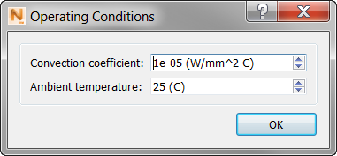

  8. Click Operating Conditions, set the Convection coefficient to 1e-05, as shown below, and click OK.

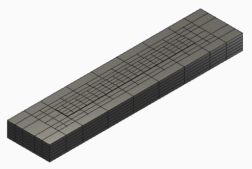

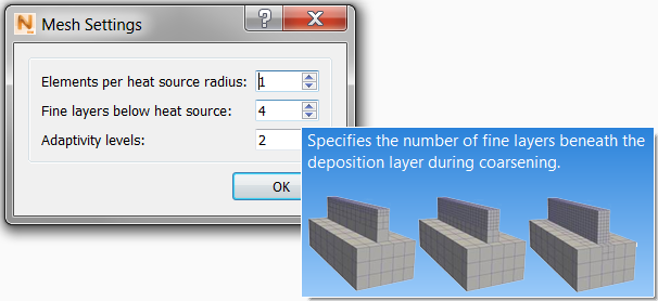

  9. Click Mesh Settings, and set the values shown below.
    Note that each setting here has an illustrated tooltip:
    • Elements per Heat Source Radius controls the mesh density.
    • Fine Layers Below Heat Source sets the number of layers that are kept fine, and not adapted below the heat source.
    • Adaptivity Levels specifies the maximum number of coarsening generations in the mesh.
  10. Click OK to close the Mesh Settings dialog, then click Mesh Preview and save the project in a suitable location. Load the mesh when it's available, and inspect it.

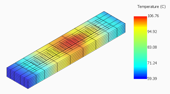

  14. When the results load, click the light bulb to turn on the Temperature results.
  15. On the Results tab, open Plot Settings, set the Displacement Scale to 10 to magnify the displacement results, and click OK.
    Play through the results, remembering that the front end of the build plate is fixed. We see the back end of the build plate deflect upwards.
    We can follow the deposition passes and see that toward the end, slightly higher temperatures remain in the part, causing the upward deflection of the build plate.

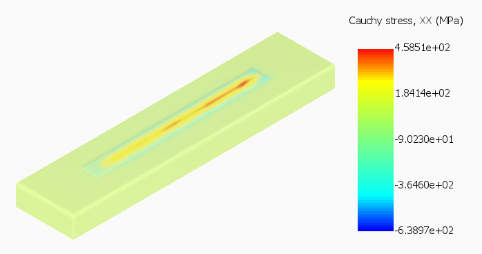

  16. Turn on Cauchy stress results to verify the presence of some stress at the end of the build. On the Display tab, check that the Component value is XX to focus on the longitudinal stress, and change the Range setting to Global.
    The figure above shows stress levels at the end of the build. For better visibility, element edges were turned off in the Browser by deselecting the Element Edges bulb.
