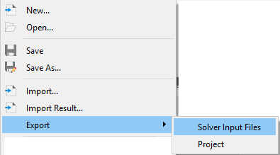

  6. Click Simulation menu > Export > Solver Input Files.

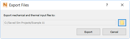

  7. In the Export Files dialog, click the Browse button, create a new folder in a good location and name it Example 11. Select this folder, and back in the Export Files dialog, click Export to save the input files.

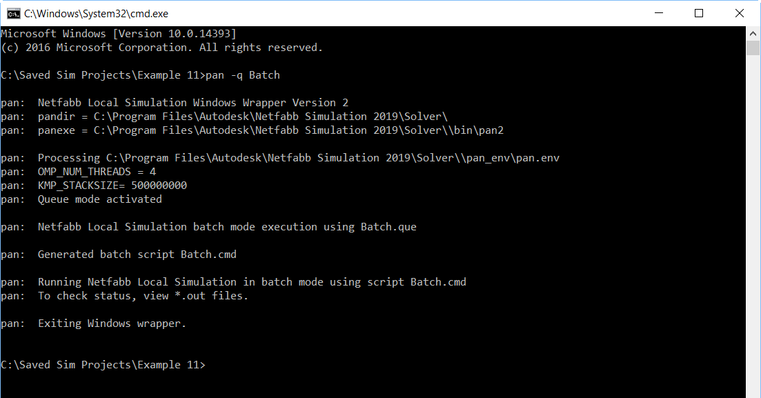

  14. Save and close the batch file, and then open the command terminal. The most efficient method to do this is to click the cursor in the Windows navigation bar in the Example 11 folder, which selects the file path, then type cmd and press Enter to execute. This will bring up the command prompt starting in the Example 11 directory. Alternatively the command prompt can be opened from the start or run menu, and you can navigate to the Example 11 directory using the cd command.
  15. To execute the batch command, type pan -q Batch from the command prompt, and then press Enter.
    pan is the solver executable, -q indicates a batch file will be used for the inputs, and Batch is the name of the file, without the .que extension. The execution and output returned from the solver should look similar to the following (with updated product version numbers):
    The solver ran the four simulations in sequential order. In the Example 11 folder, you should see .out, .case, and other output files for each simulation.
