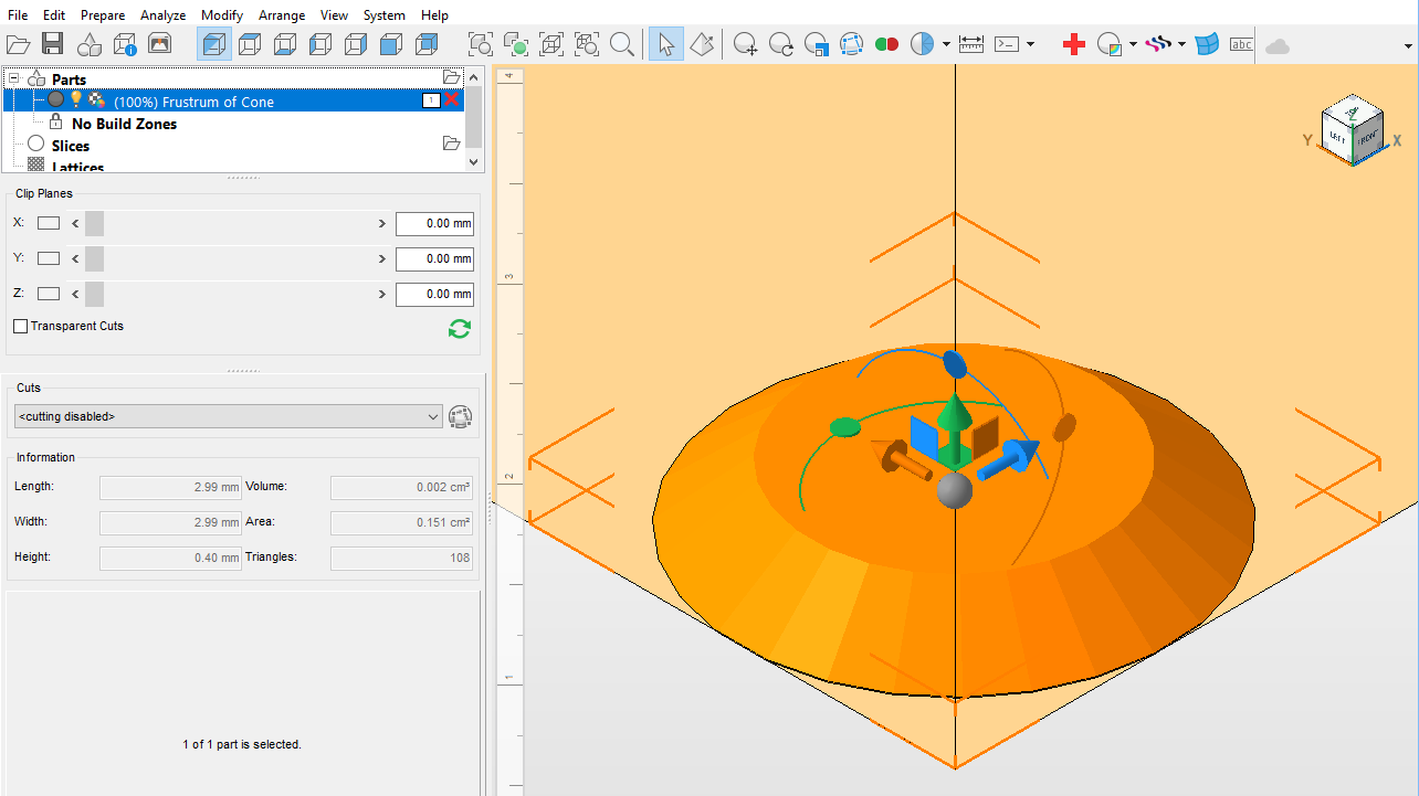

  1. Open Netfabb Premium or Ultimate.
  2. Click File > Add Part and from the sample files subfolder Example_20, import the file Frustum of Cone.stl as shown below:

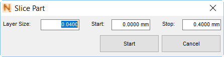

  3. On the Project Tree, Parts node, drag and drop the Frustrum of Cone file under the Slices node. The Slice Part dialog opens.
  4. Set Layer Size to 0.0400 mm and click Start to run the slicing operation.

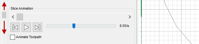

  5. To see the slices, use the Slice Animation controls. Drag the vertical marker to the bottom of the scroll bar and then click the Play button to see the contours of each slice:
    Slicing produces only the outside contour of each slice. Hatching must be added to create the laser vectors.

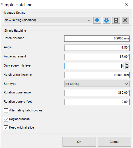

  6. Under Project Tree, Slices node, right-click Frustrum of Cone, then select Generate Filling > Simple Hatching.
  7. In the Simple Hatching dialog, check that the following values are set:
    • Hatch Distance: 0.2 mm
    • Angle: 11.5°
    • Angle increment: 67°
    Leave the other options at default values, and click OK.
  8. This operation fills in the contours with hatches. Again use the Play button and the vertical scroll bar to review the hatches created.

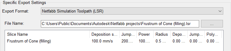

  9. Under the Slices node, right click the Frustrum of Cone (filling) item that was created in the last step, and select Export > as LSR. The Export Slices dialog opens. The critical part of the dialog is shown below.
  10. In the File Name field, browse to a suitable directory and name for later use of the LSR file.

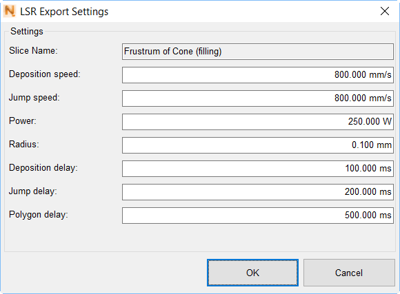

  11. In the large field below File Name, double-click the name under Slice Name to open the LSR Export Settings dialog. Adjust the settings as follows:
    • Deposition speed: 800 mm/s = rate at which laser is rastered
    • Jump speed: 800 mm/s = travel speed of laser between laser passes
    • Power: 250 W = Nominal laser power
    • Radius: 0.1 mm = Melt pool radius, nominally equal to laser diameter
    • Deposition delay: 100 ms = Interlayer dwell time
    • Jump delay: 200 ms = Dwell time between laser passes
    • Polygon delay: 500 ms = Dwell time added after directional changes
  12. Click OK to accept these options, then click OK in the Export Slices dialog to save the LSR file in the specified directory.
