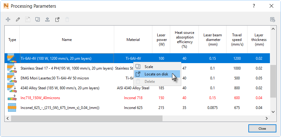

A failed PRM file is shown in red text. This indicates that the system has found an error in the file properties. A user can investigate the situation by selecting the PRM file and clicking the Edit button along the top of the dialog.
The Processing Parameters dialog allows you to manage the library of PRM files, using the right-click menu shown above, and the small icons across the top of the dialog. Left to right, the icons are used as follows:

– Open the directory that contains the selected PRM file; same as the menu option Locate on disk.
– Delete the selected PRM file and associated files. The generic PRM files supplied with Simulation Utility cannot be deleted.
