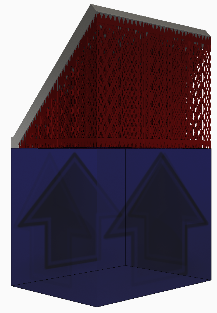

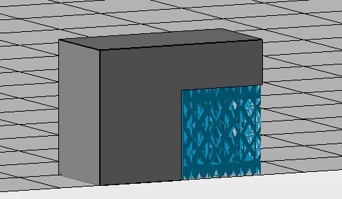

The first figure below shows lattice support structures. The volume fraction is small, meaning that only a small portion of the total volume of the support region is occupied by solid material. Meshing a fine lattice adds a significant number of small elements and thus degrees of freedom, which extends the run time of the simulation and increases the required memory usage.

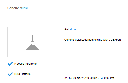

  1. Launch Netfabb, and if you see the My Machines dialog open, showing the Generic MPBF machine, right-click the machine image and select Open Machine. Skip to Step 5 below.
  2. To select a machine, first click Home tab > My Machines .

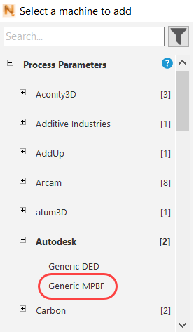

  3. If it's not already there, add Generic MPBF to your list of machines.
    1. In the My Machines dialog, click the Add Machine button.
    2. In the Select a machine to add dialog, scroll down the Process Parameters list, expand the Autodesk category, and click Generic MPBF.
    3. Click the Add to My Machines button at the bottom of the dialog.
  4. In the My Machines dialog, with the machine selected in the left pane, click Open.

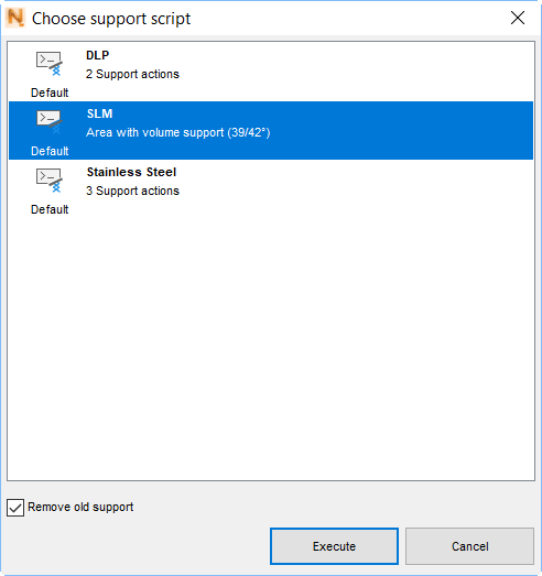

  8. At the bottom of the window, click Run Support Script, select SLM, and click Execute.
    The lattice-like supports are created.

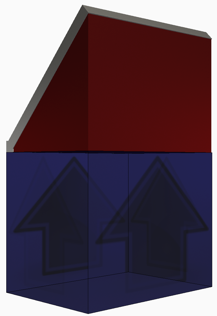

    The exported file takes a minute or so to generate, then opens inside the Simulation Utility window on a large build plate. Note that the lattice support has been replaced with a solid block.

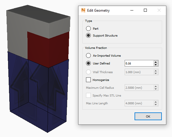

  3. In the Browser, right-click on the support structure, which has a name that includes _hulledsupport_, select Edit Geometry, and in the dialog, you see that User Defined is selected by default.
    Note that the Volume Fraction brought over from Netfabb was automatically calculated at 16%. Click OK. Next, generate a mesh preview to see the results of homogenization.

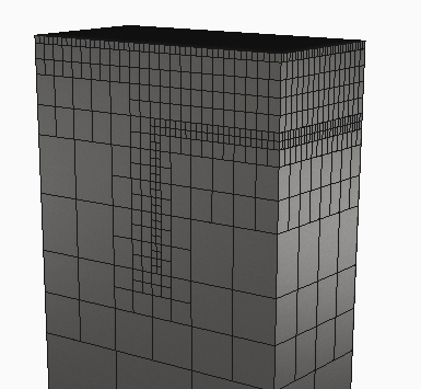

  4. On the Home tab, click Mesh Preview and save the project in a suitable location.
    Upon viewing the results observe that coarse mesh elements are used where the part and support are near the build plate, and fine elements along the interfaces between the part and support. This part will simulate in a much shorter time than if the original lattice like supports had been used, while attaining the same predictions of thermo-mechanical behavior during processing.
