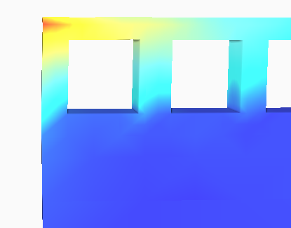

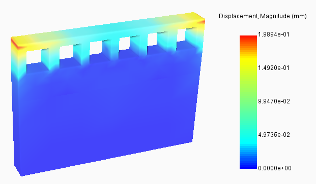

Original displacement results
The figure shows simulation results using the file Example_12.stl. Note the areas of maximum displacement at the upper, outer corners of the original part. A closer look shows that these outer corners are displaced slightly inward, toward the center of the part.
When we prepare a compensated STL, we can expect to see the geometry offset in these corners so that displacement during the build will modify the geometry into the desired final shape.

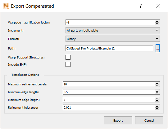

. The
Export Compensated dialog opens.
A positive value of 1 in the Warpage Magnification Factor field would export an STL file showing the predicted displacements. A value of –1 would produce a completely compensated STL, applying the full simulated displacements to the original STL dimensions. A value less than –1 would produce an STL file with exaggerated compensation, and a value greater than 1 would produce a distorted file.

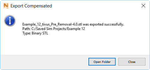

The Export Compensated dialog shows you the name of the warped STL file, which contains the warpage magnification factor in an extension of -4.0.stl, and the path to the file.
The file name also includes the string _Pre_Removal if you used the Increment setting All parts on build plate, or the string Post_Plate_Removal if you used the setting After removal from build plate.

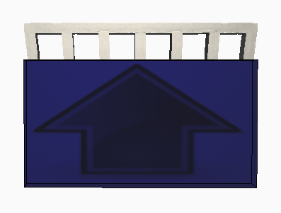

You should notice that the upper corners are pushed outward to compensate for the expected inward displacement. The warpage magnification factor of -4 was intended to show displacement that is clearly visible, but this value is too extreme to use in practice.
