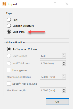

  1. In Simulation Utility, create a new simulation, browse to your saved Examples folder, and from the Example_23 folder, import buildplate_thin.stl.
  2. In the Import dialog, under Type, click Build Plate, and leave Volume Fraction at As-Imported Volume.

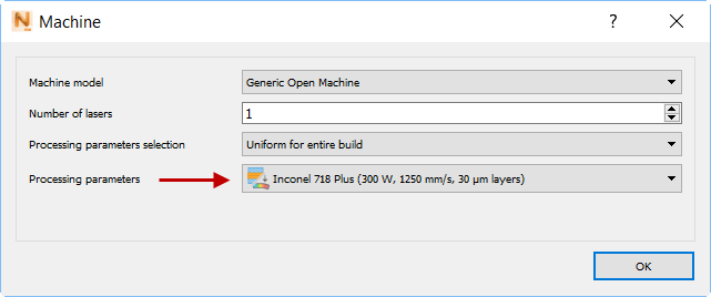

  4. On the Home tab, click Machine, and set Processing parameters to Inconel 718 Plus.

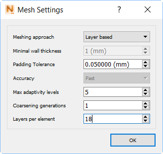

  7. On the Home tab, click Mesh Settings, then set Meshing approach to Layer based, Coarsening generations to 1, and Layers per element to 18, as shown below.

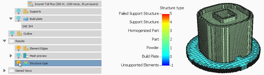

  8. Click Mesh Preview, and save the project with a suitable name and location.
    When the mesh is displayed, you can check it for errors. In the Browser results, click the lightbulb for Structure type to see the color-coded types before the simulation.

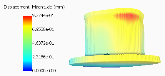

  10. Display Displacement results, then in the Display panel, set the Displacement scale to 5.00.
    With displacement results exaggerated in this way, you should be able to see quite clearly that the thin build plate has distorted during the simulation.
