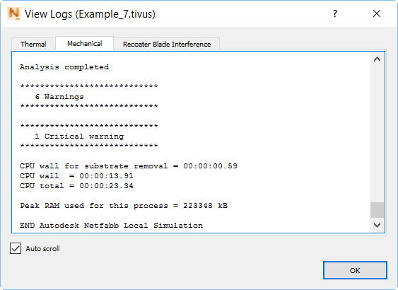

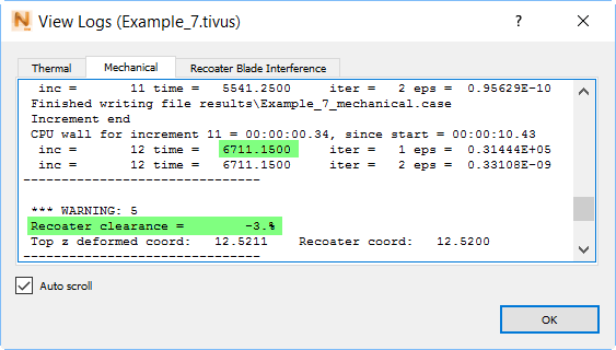

  5. To examine the deflection in more detail, click View Logs.
  6. Scroll to the bottom of the Mechanical log to check for Warnings.
    There are 6 in this case.
  7. Scroll up through the Mechanical log to find an actual warning.
    In this example, the warning occurred at increment 12, 6711.15 seconds, when the recoater clearance was –3%.

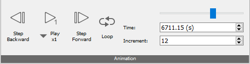

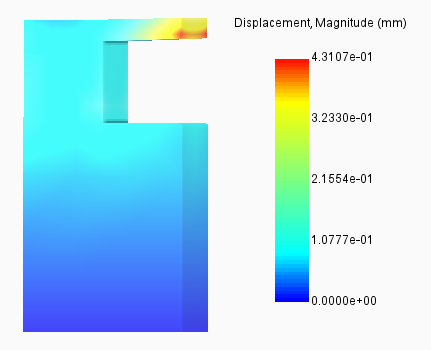

  8. To see this point in the animation, go to the Results tab > Animation panel, and move the time slider to increment 12, 6711.15 seconds.
    In the Displacement results at this time, you can see the upward deflection of the overhang.

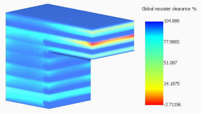

    You may also want to view the four types of recoater results. The Global recoater clearance % shows, at a glance, the extent and location of unacceptable clearance in the entire build. The default Recoater tolerance value of 80% is used here, meaning that clearance values below 80% are unacceptable:
    Note the inverted color spectrum in the legend for these results, reflecting the fact that high percentage values for recoater clearance are safe, while low values are risky.

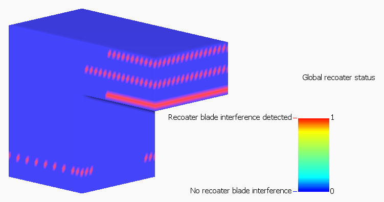

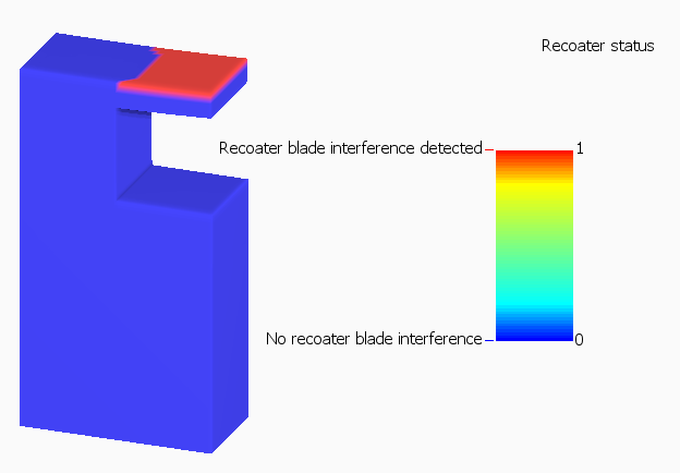

    Global recoater status shows whether any recoater interference occurred in the build, and if so, where.

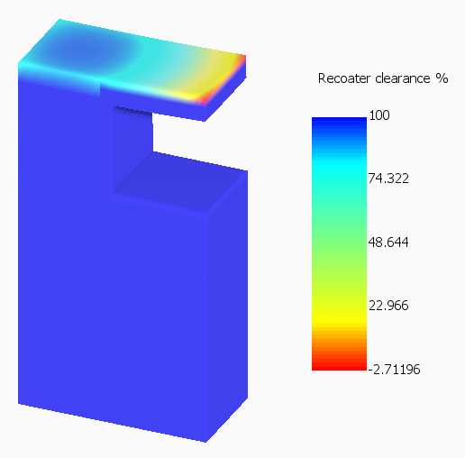

    Recoater clearance % is useful for stepping through the build increments to see how the clearance value changed as the build progressed. The figure below shows one of the most extreme increments in the build.
    Recoater status allows you to step through the build increments to see when and where recoater interference occurred.
    Seeing clear evidence of interference, an engineer could decide to add support structures to prevent distortion of the part and damage to the recoater blade.
