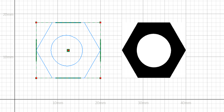

You may orient and arrange parts in 3D in the Parts section, and arrange slice stacks in the Slices section. Slices are always shown with their outboxes, helping to avoid unwanted overlaps even when the current slice layer does not contain any conflicting toolpath information, or any at all.
The Slices view is agnostic to the size of any build platform where a slice stack might have originated. The actual image size is determined during export into the desired bitmap image format. For this reason, we recommend packing in the 3D view using the Slices view only to finalize any positioning. Using drag&drop you can move multiple parts to the Slices section at once to save time. Their arrangement is kept intact during the move.
Any created slice images will originate at the outbox corner of the part positioned closest towards -X and -Y, rather than at the slice display's origin. Any offset to the slice display's origin is ignored.
The 5-millimeter offset in the slice display is dropped in the exported images, inset on the right.
