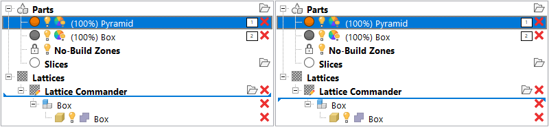

To add to a new component
  1. In the project tree, click and drag the part from  Parts or a machine workspace.
  2. Drop it onto the  Lattice Commander entry.
To add to an existing component
  2. Drop it onto the entry of a component.
The tips of the blue line indicate how Helix is added into Lattice Commander. Left: Into a new component. Right: Into the existing component named Box.

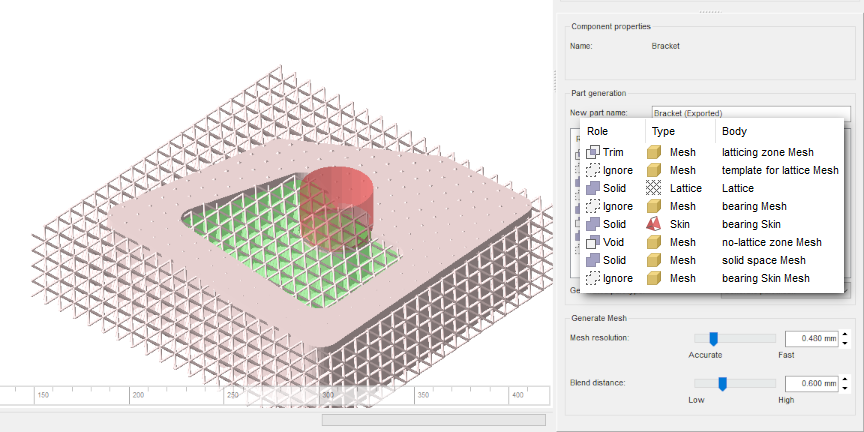

To generate a part from a component
You can export an entire component into a part. Using the roles you can set for each of the bodies in a component, Netfabb assembles them into the result. The benefit of this method is that you do not need to generate the mesh information manually. The entire mesh generation and assembly is handled automatically, producing only the final part and putting it onto the platform that was selected last before clicking Generate Component.
  1. In the project tree, select the component.
  2. Adjust the role of each body as necessary by clicking on the role icon, cycling through Solid, Trim, Void, and Ignore.
  3. Select the mesh generation method:
    • Generate part mesh creates regular-shaped triangles of uniform size. Forms neater junctions and follows rounded surfaces best, but creates small triangles even on completely flat areas, resulting in rather high triangle counts.
    • Generate part mesh (legacy) uses an older meshing algorithm. It generates larger triangles and observes hard edges best, but also creates rather large beam junctions.
    • Generate part for FEA generates the volumetric, linear tetrahedral mesh and directly writes the NAS file suitable for finite-element analysis. Clicking this will ask you for the desired file name of the NAS file to write.
  4. In the main menu, click Generate.
Tip: You can skip steps 1-3 if you have set the roles already, by clicking the role icons in the project tree, for example.
A component being previewed, with all the available roles in use. Trim volumes are shown in green, void volumes in red. Solid bodies appear in pale pink, ignored ones are hidden.

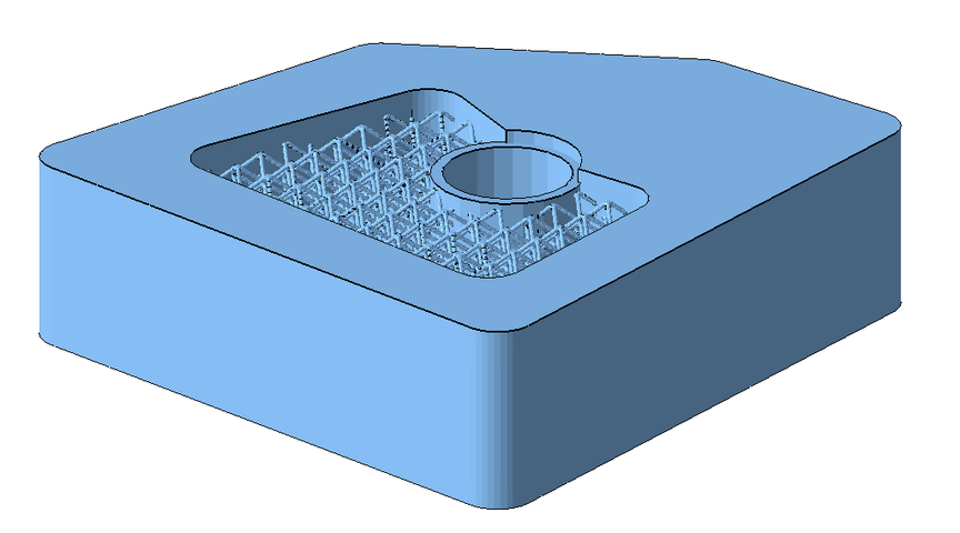

The result of generating a part from the example above.

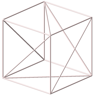

Using the same dialog, components also export to CSV, writing nodes in the format of <ElementID>;NODE;<X>;<Y>;<Z> and beams as <ElementID>;BEAM;<NodeID1>;<NodeID2>;<Radius1>;<Radius2>.
Example:
1;NODE;0.0000;0.0000;0.0000
2;NODE;50.0000;0.0000;0.0000
3;NODE;50.0000;50.0000;0.0000
4;NODE;0.0000;50.0000;0.0000
5;NODE;0.0000;0.0000;50.0000
6;NODE;50.0000;0.0000;50.0000
7;NODE;50.0000;50.0000;50.0000
8;NODE;0.0000;50.0000;50.0000
9;BEAM;3;4;0.8660;0.8660
10;BEAM;2;4;0.8660;0.8660
11;BEAM;1;4;0.8660;0.8660
12;BEAM;2;3;0.8660;0.8660
13;BEAM;1;2;0.8660;0.8660
14;BEAM;1;6;0.8660;0.8660
15;BEAM;2;6;0.8660;0.8660
16;BEAM;5;6;0.8660;0.8660
17;BEAM;2;7;0.8660;0.8660
18;BEAM;3;7;0.8660;0.8660
19;BEAM;6;7;0.8660;0.8660
20;BEAM;5;7;0.8660;0.8660
21;BEAM;3;8;0.8660;0.8660
22;BEAM;4;8;0.8660;0.8660
23;BEAM;5;8;0.8660;0.8660
24;BEAM;7;8;0.8660;0.8660
25;BEAM;4;5;0.8660;0.8660
26;BEAM;1;5;0.8660;0.8660
