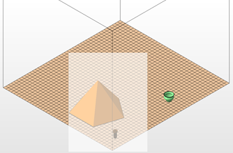

Select several parts at once with help of a window selection.
