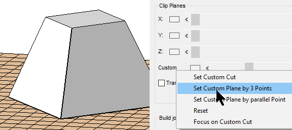

Placing the custom clip plane
The custom clip plane lets you view the cross section of parts at any angle, not just perpendicular to X, Y, or Z.
Tip: Once an angle has been set for the custom plane, you can use Set custom cut to place it anywhere on the part at that angle until you set a new one.

  1. In the Clip planes view, right-click the section of the clip plane to set.
  2. Choose Focus on cut in <axis> or Focus on custom cut, respectively.
