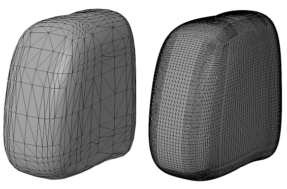

To retessellate a part
To retessellate the part for a workflow step that could benefit from a different level of mesh resolution, choose Modify > Tesselation > Retessellate model. This will provide you with a dialog to choose from tessellation presets.
The same part, tessellated with two different presets
