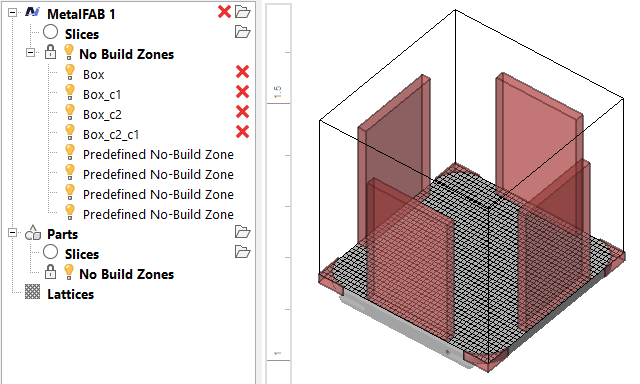

In this example, the zones at the corners are machine-specific, the zones along the sides are user-defined. All are listed in the project tree.

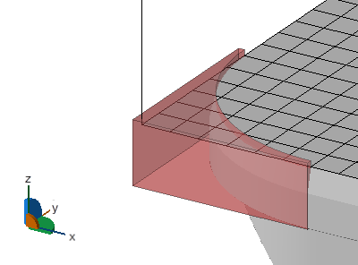

In addition, some machines come with zones already defined. These zones are part of the machine workspace definition and cannot be modified.
Example of a no-build zone as defined by the machine workspace
