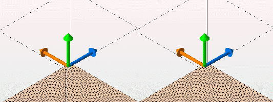

Coordinate System
The perspective indicator, a representation of the global coordinate system can be configured in several ways. Set here its size as a percentage of the display's size, as well as the visibility and size of the colored planes. They vary between the minimum and maximum value, depending on the current perspective, with planes in the background always displayed larger than those in the foreground. The planes, when displayed, can be used for changing the perspective by clicking on them.
This is also where you switch between the regular perspective indicator and the viewcube, and in which corner of the display it sits.
The two styles of perspective indicator in Netfabb: the coordinate system and the viewcube

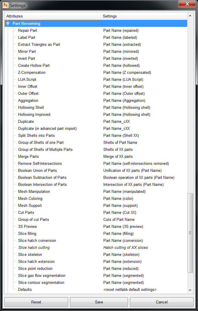

Part Renaming
The part renaming specifies the name applied to parts after they are modified, or more accurately, to the parts generated by those modifying actions. The name of the original is always part of the new name. To change renaming settings, double-click on a function in the list, or click on the button "..." which appears to the right of the function after you click on it once. A dialog appears to change the automatic renaming. You can insert what is added before or after the part name in the text fields left and right of "part name". Below, you can see a preview of how your parts are named. "Part name" always refers to the name of the original part. With the button Set to defaults at the bottom of the dialog, you can restore the default naming for that particular function. The default setting for repaired parts, for example, is that "(repaired)" is added to the original part name.
Create Hollow Part, Inner Offset, Outer Offset, and Hollowing Shell refer to the respective options for the function Create shell. Group of shells of one part and Group of shells of multiple parts stand for the names of the groups into which the shells are moved with Shells to parts. Similarly, Group of cut parts refers to the group into which cut parts are moved.
Functions for which the automatic part renaming can be altered

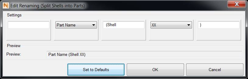

For functions that may create several parts at once, or that process several parts at once, such as Duplicate, Shells to Parts, Cut parts, and Merge parts, there is the additional field "XX". This is only enabled, when the box below is ticked. When several parts are created at once, the "XX" stands for a number which gets inserted for each part name. When you duplicate a part, for example, the copies are by default named "Part name_c00", "Part name_c01", "Part name_c02" and so on. When several parts are processed by a function, the "XX" stands for the number of parts processed, as for example in "Merge of 2 parts".
The dialog box for changing the automatic renaming for Shells to parts.
Any modified renaming items are written in italic letters. By using the very last item in the list, Defaults, you can restore the default naming settings for all functions.
