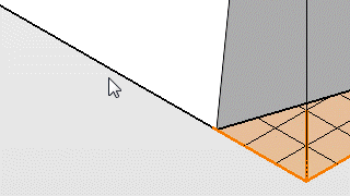

Properties such as position, length, and angle are measured by choosing and placing selection primitives, or tools, onto the part surface. The combination of the tools used at the start and (if required) end of the measurement determines the type of property to be measured. As you place the first and, if necessary, the second tool, the measurement is automatically generated and displayed.
Most of the tools have a drop-down sub-menu to select the second tool and thus the type of measurement, and any measurement that would not require a second tool, such as measuring the radius of a circle, have that measurement as the last item in their respective sub-menu.
The results are now displayed on the model using a text label as well as an entry on the Measurements tabsheet in the context view.
