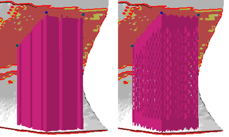

Filling Type
Switch the support walls between Hollow (solid) and Structured.

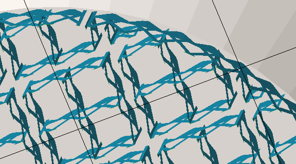

  • The fragments that make up hollow supports are essentially box-shaped columns. They are closed on all sides, even at top and bottom. The connection with the part surface is facilitated by small pins.
  • Structured supports are, by default, akin to patches of intersecting wire fence. Also, the entire cluster area is enclosed by a single wall along the circumference, ie. the cluster's contour.
Applied default hollow supports. A cut via clip plane demonstrates the cluster's contour, the fragments' cross section, the terminating surface at the top, and the stand-off against the part surface.
Applied default Structured supports. Note the gap in the circumference.

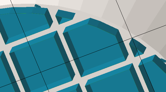

Fragments
Fragmentation creates gaps in normally continuous polyline support. Gaps make support easier to break off. See details below.

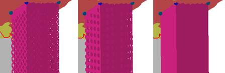

Structure pattern
Switch between Wired wall (left), a Punched plate (middle), and Solid (right) to determine the wall pattern of volume supports.

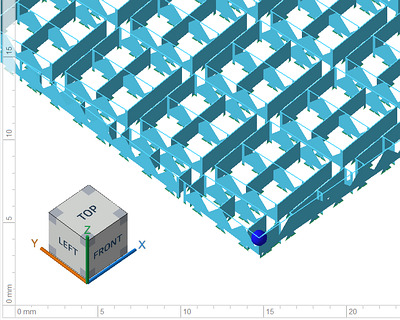

The raster is built up from intersecting polyline walls and fills the actual volume of volume support.
Rotate by Z
Sets the general alignment of filling structures. Filling structures are aligned globally, as in, against the platform coordinates.
Hatch distance
Sets the distance between the inner structure units. The number of inner structure units and the density will be affected.

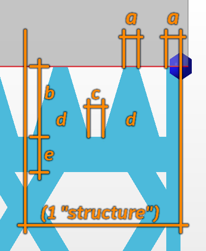

Type of connection
Select from: Strip, Trapoid, Breaking Points, Triangles.
  • Strip: A continuous band connecting to the part all along its upper edge
  • Trapoid: Triangles with truncated tips
  • Breaking points: Like trapoid, but with another, inverted row of trapoids stacked on top, forming X-shaped connections
  • Triangles: Triangles that simply terminate in pointy tips, for very delicate support attachment
Connection width
a
Connection properties
  • Does not apply to Strip.
  • For Triangles, this only applies to the vertical line at the beginning for the polyline, or contour.
  • For Breaking Points, this is the "waist" of the X-shaped connections.
The width of the vertical strip on the far right can be overridden. See Structure Properties > Border width.
Connection height
b
  • For Strip, b and e are simply cumulative.
Pin distance
c
Pins per structure
d
Distance connection to structure
e

Fragments
Fragmentation of volume supports into individual blocks makes it easier to break the supports from the part.
