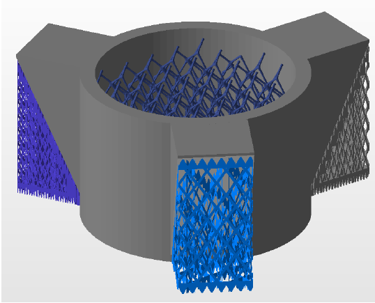

Figures 1 shows the geometry used in the present STL homogenization example. The component is a vertical cylinder with 3 spokes jutting from the sides, cut at a 45° angle. Each of the 3 spokes have support structures. The first set of supports is a solid support with a 0.100 mm wall thickness. The second support structure is a loosely meshed zero thickness STL. The third support structure is a finely meshed zero thickness STL. In the center of the cylinder a latticed structure component is also built. All 3 supports and the latticed structure will be modeled using automatic homogenization via the *STLH card. The present simulation uses Inconel 625 material properties for the build and the build plate. Support structure failure is also considered at an arbitrary support structure failure of 1800 MPa, assigned by the *UTSR card.

Figure 1: STL homogenization example geometry
The *STLH card is used to map the volume fraction choices to the STL files. It has additional control, the alpha radius, which specifies a spherical radius, which sets the maximum hole size that will be homogenized. For instance the fine zero thickness supports have an alpha radius of 5 mm, so that if any gap exists that can fit a sphere with a 5 mm radius across it, that gap will not be filled in during meshing.

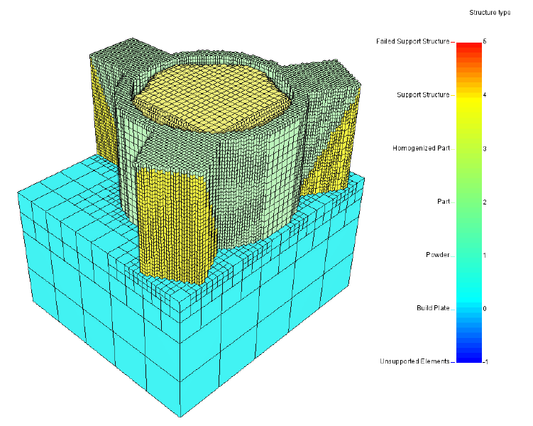

Figure 2 shows the mesh and the structure type of the part. Observe the homogenization of the lattice and support structures.
Figure 2: STL homogenized mesh with structure type
