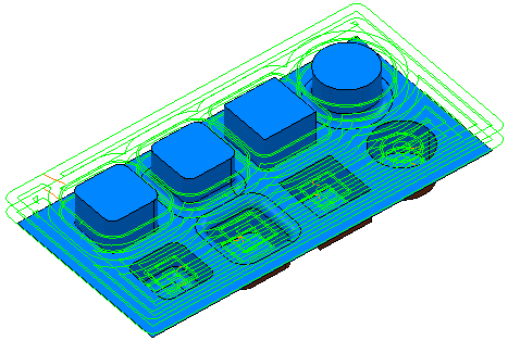

Machine flats — Select how to identify flat areas on the model. These options determine the location of the machining level heights.

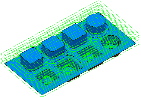

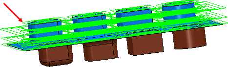

Looking from a different angle, you can see that only the flat areas are machined in the first level:

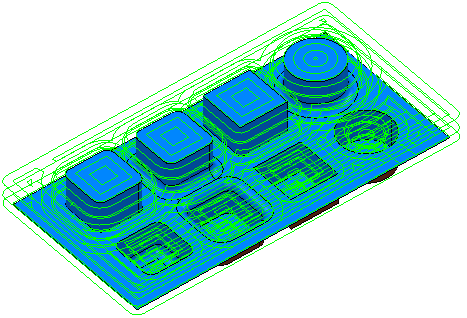

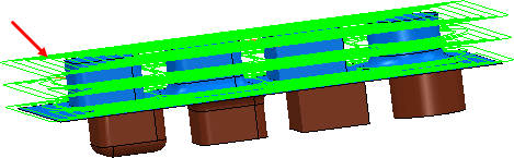

Looking from a different angle, you can see that three complete levels are machined:

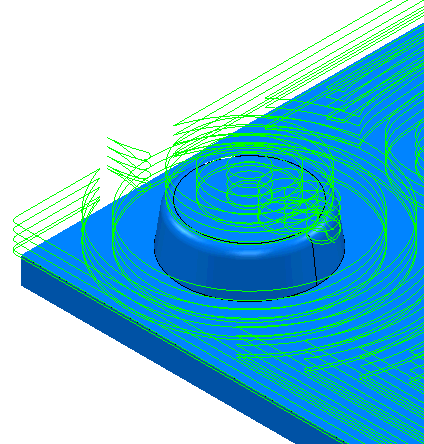

Allow tool outside flat — Select this option to allow the tool to go outside the flat area. This alleviates the problem of running the tool along a sharp edge.
Approach allowance (tool diameter units) — Enter the approach outside as a percentage of the tool diameter.
