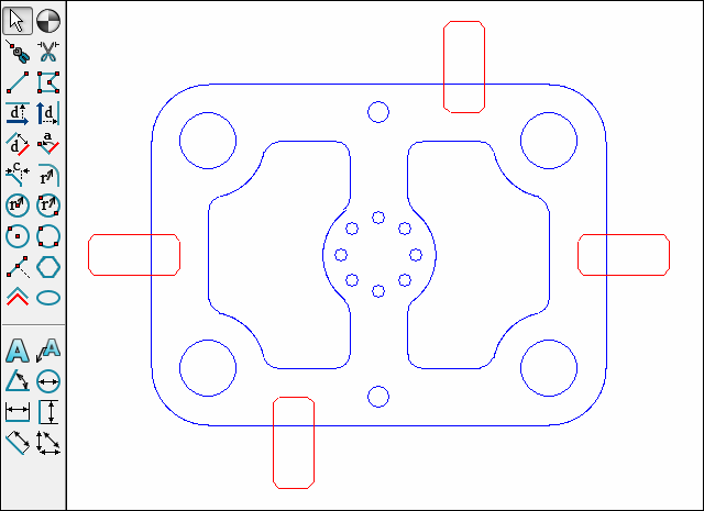

- Using PartMaker's CAD mode, create 2D representations of the location of the work holding. In the following example, four hold-down clamps have been created:

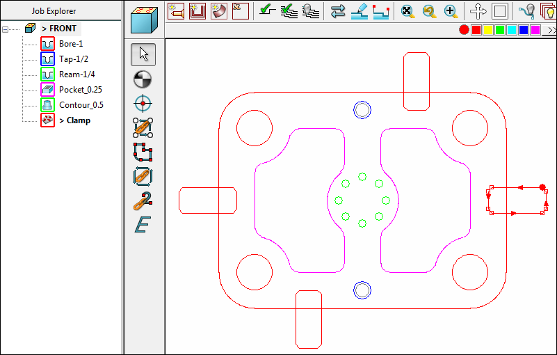

- Switch to CAM mode, and select Part Features > Define Clamps.
- Complete the Clamp Group Parameters dialog to specify parameters for the clamp group, including its name.
- In the same way in which you assign a part feature to geometry when defining a toolpath, use the Chain Geometry icon to assign the clamp group to the clamp geometry you created in Step 1, for example:
