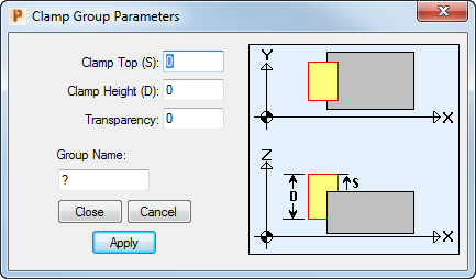

Use the Clamp Group Parameters dialog to define work holdings, such as hold-down clamps or vices.
The following settings are available:
Clamp Top (S) — This is the distance from the part to the top of the clamp.
Transparency — This value specifies how transparent the clamp should appear. 0% creates a solid clamp, 100% creates a fully transparent (invisible) clamp.
Group Name — Enter a name for the clamp group. This appears in the Job Explorer pane of the Face window.
Close — Click to save any changes and close the dialog.
Cancel — Click to close the dialog without saving any changes.
Apply — Click to apply your changes without closing the dialog.
