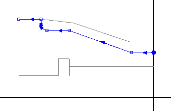

    • Click to create a profile for the part profile, then click and define the profile on a contiguous piece of geometry:

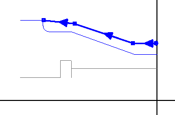

    • Click to create profile for the stock profile, then click and define the profile on a contiguous piece of geometry:

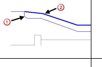

    PartMaker displays both profiles in the profile group color and uses a:
    • thin line for the part profile (see )
    • thicker line for the stock profile (see )
    To change whether a profile represents a part profile or stock profile, double-click a profile line to display the Profile Properties dialog and change the profile type.

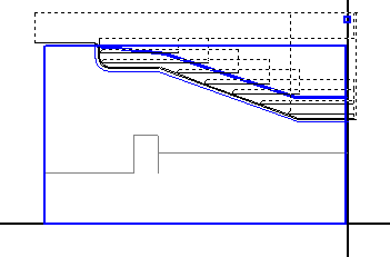

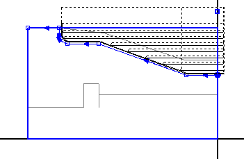

  6. To verify the toolpath for the profile group, select the profile group in the Job Explorer and select Part Features > Verify Work Group Tool Path. PartMaker verifies the toolpath. The following example compares the toolpaths created when a stock profile defines the cutting limits and when a part profile defines the cutting limits:
Cutting limits defined by the part profile:
Cutting limits defined by the stock profile:
