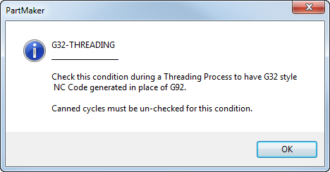

Use the User Data dialog to activate User Conditions and assign values to User Parameters that are available for the Post Configuration file you are using for the .job file.
To display the User Data dialog, click the User Data button on any of the following dialogs:

On the User Data dialog, you can:
Note: For a complete list of the User Conditions and User Parameters that are configured in the Post Processor, refer to the User Data section in the Post Processor Reference Guide.
