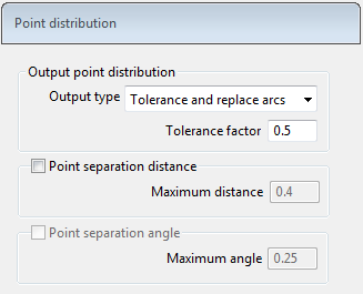

Use the Point distribution page to control how points are distributed along the cutting moves of a toolpath.
Note: Use Solids > Set View > Show Toolpath Points to control whether toolpath points are displayed in PartMaker.
Output point distribution
Output type — Select the type of point distribution along the cutting moves.
Tolerance factor — Enter a value to determine how many points are removed. This must have a value between 0 (removes a minimum number of points) and 1 (removes a maximum number of points while maintaining tolerance, so the toolpath contains the minimum number of points).
Point separation distance — Select to limit the maximum distance between consecutive cutting move points.
Maximum distance — Enter the maximum distance between consecutive cutting move points.
Note: These options are not available if you select an Output type of Fit arcs.
Point separation angle — Select to limit the maximum change in angle between consecutive cutting move points.
Maximum angle — Enter the maximum angle between consecutive cutting move points. This is useful when approaching the gimbal lock position of your machine tool, where small angular changes can lead to large changes in the azimuth and elevation angles. To ensure the maximum angle is not exceeded, PartMaker adds additional toolpath points, which slow the machine tool.

Note: These options are available only if you select an Output type of Redistribute.
