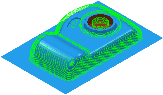

Constant Z finishing creates a toolpath by slicing the model at specific heights (or levels). This works well on near-vertical surfaces that require a consistent depth of cut.
